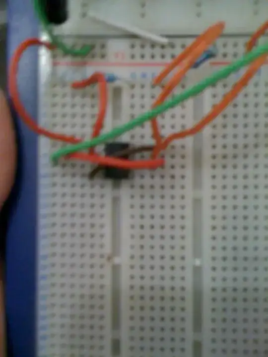

Here is a picture of my current prototype construction: enter image description here
It's an arduino which programs the Si5351 module, which outputs 144 Megahertz. I then measure the input and output of my transistor amp.

I know I have a pretty long wire running from the Si5351 but I'm not looking for perfection yet, and the signal makes it across OK - it's literally the transistor doesn't appear to be amplifying at all, even though it's supposed to be a higher frequency transistor.
I can't imagine it's my layout that is causing it to simply NOt amplify at all.
My oscilloscope probe is set to 10x and I'm using the super short probe spring ground. The scope is a 200Mhz scope with 200mhz probes.
