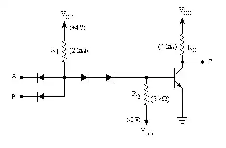

This may be a vintage question, I'm not sure. I am self-studying electronics using some old books and came upon the problem below from "Basic Electronics" by RCA Institutes, 1965. The book is fantastic, but some of the terminology and tech is ancient. The answer to the problem in the book is as follows:
The difference in potential between points C and D is 3 Volts. The potential at point B with respect to ground is +1 Volts; at point C 0 Volts; and at point D -3 Volts.
My read of the circuit is that there are 6 volts in the circuit, but I'm confused by the ground at point C. If C is ground and ground is 0 Volts, then it would seem that 6 volts would drop between the positive terminal and point C, meaning that 4 Volts would drop between A and B and 2 Volts between B and C. Similarly, there would be a 6V drop between the source and point C going from the negative pole to ground.
Obviously, I am mistaken, but I'm at a loss as to how to analyze the circuit and pull out the different potentials. I am hoping y'all can shed some light on how they came up with their values.
Ground and positive and negative voltage problem

    Notice that the negative side of the battery is *not* connected to ground directly. So the negative side of the battery is *not* at ground potential. A batteries negative terminal isn't automatically ground, only if you connect it to ground. – Unimportant Dec 28 '20 at 16:50
Ground is just our reference point, against which we measure voltages. Current is not flowing into or out of it (in this example).
Because the resistance above and below the ground point is equal, we know that current passing over these resistances will drop the same amount of voltage.
The total resistance of the circuit is represented between points A and D...this is where 6 V will be dropped.
Point C is midway through this resistance. Therefore, there is 3 V drop between A and C and another 3 V between C and D.
Using Point C as our reference for "zero volts", point D will be -3 V and point A will be +3 V. This, of course, shows our total of 6 V across the whole circuit.

The key word is ‘difference’. When you see that word, think IR drop: the local voltage difference on a component with current flowing through it.
For the first part of the question, we know a couple of things:
  • no current flows to or from GND (single-point connection)
  • meter at terminals C and D will show a reading of 3 volts.
What’s the polarity of that meter reading? Strictly speaking, we don’t know: it depends how you hook up the meter (the question doesn't specify.) We only know that we will see a difference, that is, the IR drop between points C and D of 3V. We know this because C to D is half the total resistance, and therefore is also half the total IR drop.
Nevertheless we can figure out the C to D voltage polarity since we know the direction of the current from the battery: the current flows from A to D, and therefore C to D. C will be 3V more positive than D. That is, the meter with the (+) probe on C and (-) probe on D will measure +3V.
We can apply a similar analysis to the other points to come up with the other local IR drop values. We know these will be 2V for points A to B and and 1V for points B to C, respectively. As a sanity check, add the individual IR drop voltages together: they should be 6V total, the battery voltage.
Now for the rest of the question the voltage values refer to a meter connection referenced to ground. Because they also ground the circuit at point C, this says effectively that the meter (-) probe is on point C.
This meter connection will make all the measured voltages be offset by the 3V IR drop between point C and D, compared to if they grounded the circuit at point D, the battery (-) terminal.
Knowing this, the points A, B, C and D will measure ... 3, 1, 0 and -3V with respect to ground (point C) vs. 6, 4, 3 and 0V with respect to the battery (-) (point D).
The point they’re trying to get across is the distinction between a local IR drop measurement for a component vs. a ground referenced measurement for the whole circuit.

First, analyze the circuit without the ground connection. There's 6V from the battery across a total resistance of 450 ohm. So $$\frac{6V}{450\Omega}= 13.3mA$$ will flow trough the circuit. This means the 225 ohm resistor will have a voltage across it of $$13.3mA * 225 \approx 3V$$ Thus, point C will be at 3V, relative to the battery's negative pole. (=point D)
However, if we connect point C to ground and take ground as our negative reference for measuring voltage, then point D is at -3V, relative to point C (=ground).
You seem to be confused because of assuming that a negative battery terminal is automatically at ground potential. It's not, only if you connect it to ground.

Ignore the ground symbol for the moment.
From A to D, you will have 6 volts. That is, if you put the negative terminal (black) of the voltmeter on point D (the minus pole of the battery) and the positive terminal (red) of the voltmeter on point A (the positive pole of the battery) then you will measure 6 volts.
The current is 6 volts divided by the sum of all the resistances : \$I = \frac {6}{150 + 75 + 225} = \frac {6}{450}\$
From \$I\$, you can calculate the voltage drop across each resistor.
  • From A to B is \$ 150 \times I\$
  • From B to C is \$ 75 \times I \$
  • From C to D is \$ 225 \times I\$
If you assume that D is at zero volts, then you get the following voltages:
  • D = 0
  • C = 0 + \$ 225 \times I\$
  • B = 0 + \$ 225 \times I\$ + \$ 75 \times I \$
  • A = 0 + \$ 225 \times I\$ + \$ 75 \times I \$ + \$ 150 \times I\$
That's if you ignore the ground symbol.
Putting the ground symbol at point C means that you should measure all voltages relative to point C - point C is your "zero volts" point rather than point D.
That is, put the negative terminal (black) of the voltmeter on point C and the positive terminal (red) of the voltmeter on point A to make your measurement. The voltages relative to the battery minus pole don't change, but the voltages you measure will be different because you aren't measuring against the minus pole of the battery.
If you assume that C is at zero volts, then you get the following voltages:
  • C = 0
  • B = 0 + \$ 75 \times I \$
  • A = \$ 75 \times I \$ + \$ 150 \times I\$
  • D = 0 - \$ 225 \times I\$
The difference between voltage A and voltage D is always 6V. The voltages must all add up to the same 6 volts that your battery provides, but you can measure them relative to any point you like.
You could put the ground symbol on point A, and measure the other points relative to point A. The total will be the same, but you'll have different voltages.

The key to understanding positive and negative voltages in a circuit, for me, is first figuring out the amount of voltage in the circuit, in absolute terms, and figuring out the amount of voltage dropped across the loads and then deciding on the reference point to use - aka ground.
Some notes based on what I've learned, thanks for the answers above that helped a lot:
A ground symbol in a circuit diagram specifies a common connection point that by convention is assumed to be at 0 volts relative to the circuit.
The negative terminal of a battery in a circuit diagram is often assumed to be at 0 volts, but this is not always the case. Particularly, when there is a ground symbol located elsewhere in the diagram!
So, I have found there to be three cases to consider with where ground can be, in the circuit - common to the negative terminal, common to the positive terminal, between two loads in the circuit:
  1. At the negative terminal
If the ground is connected common to the negative terminal, the full potential (a positive potential) of the battery is dropped between the positive terminal and ground and any potential measured in the circuit will be greater than or equal to 0 volts.
  1. At the positive terminal
If the ground is connected common to the positive terminal, the full potential (a negative potential) of the battery is dropped between the negative terminal and ground and any potential measured in the circuit will be less than or equal to 0 volts.
  1. Between two loads
When the ground is placed between two loads in the circuit, the potentials between the positive terminal and the ground will be positive and the potentials between the negative terminal and the ground will be negative.
This makes sense, because Kirchoff says the sum of the potential differences around any loop is zero.
