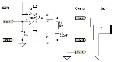

There's one part of that later article in particular I'll summarize here: What's important is that the impedance of both lines is the same, so that noise will result in the same voltage, so that it can be rejected as common-mode. Having an opposite signal on the negative side doesn't matter at all. In that article, there's a schematic, under the section Hey! That's cheating:
balanced line driver schematic
See the article for detailed discussion, but you can plainly see that pin 3, the negative side of the signal, is just a connection to ground through a resistor. As it turns out, if you disassemble a lot of professional audio equipment, this is precisely the type of line driver they use. It's because it has quite a few advantages:
  • Simple
  • Easy to balance
  • If pin 3 is connected to ground on an unbalanced input, nothing bad happens
The only critical part here is making sure R2 and R3 are exactly equal. Use 1% or better resistors, or balance them with a Wheatstone bridge for best common-mode rejection.

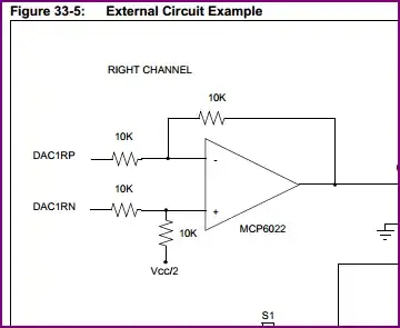

If I understand correctly, you want a circuit that generates the sine wave and also provides two versions of it 180 degrees apart. This could be easily achieved with a microcontroller, like a dsPIC with dual 16-bit DAC with differential outputs on each channel (such as the dsPICfJ64GP802 - here is the DAC peripheral manual for it), here is a typical differential buffer circuit driven from one of the channels:
dsPIC DAC Buffer

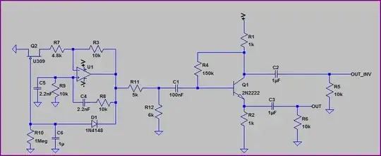

No Microcontroller
Here is a non-micro option:
Diff Output
This combines a Wien bridge oscillator (the fet can be replaced with an incandescent bulb if desired) with a simple transistor buffer which takes an output from the collector and emitter. Rails are +/- 12V (can be designed for lower if necessary)
Simulation:
Diff Output Simulation
Note that the above will sum to 2V pk-pk when it get's to wherever it's going - you can easily control the amplitude by replacing R11 and R12 with a pot.

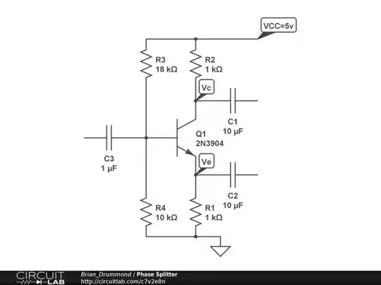

A simple phase splitter can be made from a single transistor with the same resistance in the collector (inverted) emitter (non-inverted) circuits. Its balance is pretty good but depends on the hFE of the transistor.
https://www.circuitlab.com/circuit/7v2e8n/phase-splitter/
Values should be close enough for 5V. Check that Ve is about Vcc/4 (which puts half the supply voltage across the transistor) and adjust R3 or R4 if necessary.

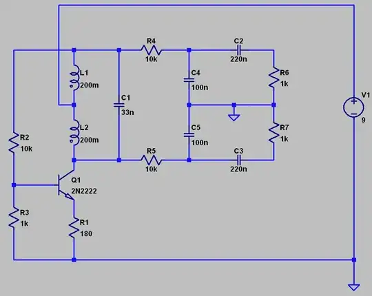

Old question but I thought I would add my 2 cents to the mix - How about a simple 1-transistor LC oscillator using the split primary of a small audio transformer? Such a solution would look something like this: lc audio osc schematic
outputs on R6 and R7
