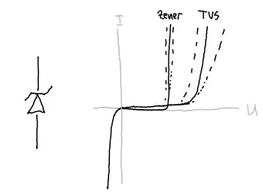

Additionally, VC is the Maximum Clamping Voltage which is the maximum voltage drop observed over the TVS diode, measured at its peak clamping current IPP. Voltage drop typically rises with higher temperature and higher voltage over the TVS.
For a transient voltage, the clamped voltage would e.g. look as the black line in the drawing. It is not flat as often drawn as simplified version.
TVS Clamping
because … the diode does not suddenly allow ∞ A after the voltage passes VBR.
References

  • Could you explain the two plots of "Zener" and "TVS"? AFAIK, the only reason a zener/avalanche type TVS has looser tolerances is, precisely that i.e. they aren't selected as tightly as zeners are (or rather the common grades of zener are a few percent, not a raw 5 or 10% as TVSs might); and because TVSs are tested to much higher peak currents (i.e. the I scales of the two curves would be different by orders of magnitude). With equal scaling, I would expect an MOV to look somewhat like the "TVS" curve as shown. – Tim Williams Jun 15 '23 at 00:57
  • I unfortunately don't have more resources on that other than AN1142 (third page), they do not give a physical background, only that normal Zeners and Zener TVS are optimised for different purposes (peak pulse vs accurate voltage). – Simon A. Eugster Jun 15 '23 at 05:46
