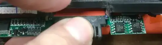

In Oct 2020, I opened it up. It contained an IC (SH79F329AX) that seemed to the be boss of the charge management system and two transistors (MT8103) connected in series with opposite polarity (typical of battery management systems). The picture of one of the cells is also attached. There was no visible sign of physical damage anywhere on the battery's constituents. The voltage of three of the cells were about 3.6 V and fairly close together. The cell #2 from the negative side was at about 2.4 V. The series string of the battery showed about 13.3 V but the output terminals of the battery management circuit (that connected to the laptop) showed 0 V. I guess the battery management controller had gone to some fault state due to low voltage on one of the cells. I charged up cell #2 using an external Li-ion charger to the voltage approximately equal to the rest of the cells. The output of the charge management circuit still showed zero. So I looked up on internet and shorted the positive output of the circuit with the positive end of the cell string, in accordance to one of the suggestions. The circuit came up live. I used the battery in the laptop. It gave a good back up of 30-40 minutes with full CPU usage and up to 2.5 hours with light document editing. The battery now charged up at about 1% per minute with the stock charger, which is a sign of a healthy battery in my understanding. I usually used the laptop while connected to the charger except for occasional moving around for a few minutes and discharged it to 15 % 2-3 times a week. The setting was warning at 20%, hibernate at 10%.

BMS controller transistors in series with opposite polarity one of the cells

First if one of the cells of this battery has been down to 1.5V the battery should be replaced.
You bought a battery with a warranty of six months so I expect the cells and BMS not to be of the best quality. Quality battery warranties are in the 1-3 year ranges.
The cell seems to charge ok and retains its good state for some time so I suspect the BMS is the problem.
The BMS could be causing this problem. As the battery comes up to full charge the voltage across each cell increases. If this increase is uneven the BMS connects a small load across the higher voltage cells in order to attempt to equalize the cell state of charge and hence voltage. This is referred to as top balancing.
The load is connected using a MOSFET. A common failure mode of MOSFETs is to go short circuit. This would leave that load connected across the cell resulting in it constantly discharging, which seems to fit with the symptoms of your problem.
The way to confirm this is to measure the current in the balance wires while the battery is charging at a low state of charge, below the balancing threshold. Any differences in the cell 2 wires compared to the others would indicate that this is the problem.

  • I tried to confirm the mode of failure you mentioned, i.e. the cell #2's balancing MOSFET shorted. I left the battery disconnected for about 16 hours. When I checked the cell voltages after this time, they were 3.91, 4.00, 3.90, 3.90. The cell #2 voltage is still 0.1 V higher than the others probably from the last manual charging a few days ago. With these results, I suspect the balancing MOSFET of cell #2 is not permanently shorted unlike as you suggested. If the cell #2 has been discharging for 16 hours, its voltage should have been somewhat lower than the other. – paki eng Dec 24 '20 at 10:06
