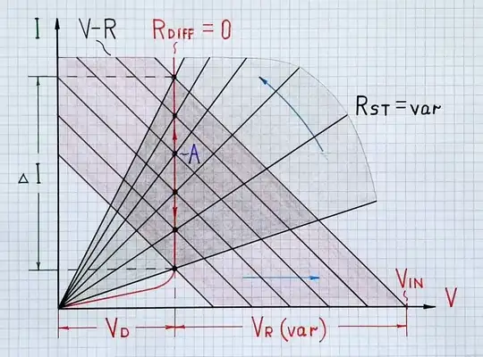

Graphical representation
EDIT. The operation of the input circuit can be illustrated graphically. For this purpose, the three elements of the input circuit part are divided in two parts - an imperfect voltage source VIN with internal resistance R and the base-emitter junction (diode). The resistor R is included for convenience- it enlarges the input voltage range, protects the junction and makes the operating point more stable.
The IV curve of the real voltage source is a vertical line (in black) that is shifted to the right with VIN and inclined to the left with an angle determined by R; the IV curve of the base-emitter junction (in red) is the well-known exponential diode curve. Since the same voltage is applied across both parts and the same current flows through them, their IV curves are imposed on the same coordinate system - Fig. 1. The intersection (operating) point A represents the present voltage VA and current IA... and this is the graphical solution of the circuit equation.
Diode as a dynamic resistor
Fig. 1. Diode as a dynamic resistor - a graphical representation (the diode IV curve is idealized). A resistor R is connected in series to the input voltage source for convenience
We can stop here as everyone does when presenting this circuit. This means taking the diode curve for granted. But I suggest to continue by imagining how this low differential resistance RDIFF can be obtained with the help of a varying static resistance RST. Thus we will visualize my initial explanations at the top where I suggested to replace the complex diode with a humble resistor. For this purpose, we replace the complex diode IV curve with the humble resistor IV line. It passes through the coordinate origin and has a slope determined by the current resistance RST.
Now, when we begin to increase VIN and its IV curve moves to the right, initially RST IV curve stays immovable and the current increases proportionally to VIN. But when VIN approaches the diode threshold (VD in the figure), RST begins decreasing simultaneously with the VIN increasing. Its IV curve begins rotating counterclockwise and the operating point changes its trajectory up.
And here the trick is - the input voltage source "sees" not the linear RST IV curve (as would be the case if it were static) but the trajectory of the cross (operating) point A... and this is the exponential diode curve.
If we want, we can conduct such an attractive experiment only by three elements - variable voltage source, constant resistor R and variable resistor (rheostat) RST... and, of course, someone that varies RST in such a way... Then the exponential diode IV curve will be an illusion created by a linear resistor.
This is a functional explanation of the phenomenon "dynamic resistance" that gives you an intuitive notion about the base-emitter junction behavior. With the same success, you can use it to explain the LED and Zener diode behavior... then, the dual transistor behavior... and finally, the negative resistance phenomenon.

  • @tlfong01, Thanks for the response; it means a lot for me. Diodes behave as voltage stabilizers. They keep up an (almost) steady voltage across themselves when the current through them varies. So, their IV curves have an (almost) vertical section. Contrary, transistors behave as current stabilizers. They keep up an (almost) steady current through themselves when the voltage across them varies. So, their IV curves have an (almost) horizontal section. I am not sure if "dual" is the right word in English... – Circuit fantasist Dec 19 '20 at 10:26
