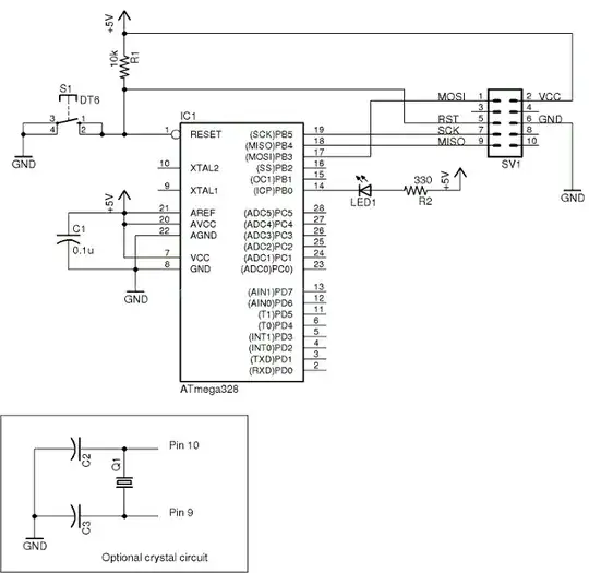

Apart from the header (which is 10-pin with some unused pins - you can use the labels as a guide for your connections, the names are the same) this schematic is about the simplest I could find with a quick Google:
Simple AVR Schematic

    If we're talking absolute minimal, you don't need the pullup resistor on the reset line - the AVR has an internal pullup. And if we're talking advisable, you should include a cap on the reset line too - see this app note: http://www.atmel.com/images/doc2521.pdf . Also, the 2x3 pin ISP header you mention is much more common than the 2x5 shown in the schematic. – Nick Johnson Jan 11 '13 at 11:04

  • @NickJohnson - thanks for the finer points - feel free to edit my answer if you wish (as mentioned I haven't used an AVR, my small micro of choice is the PIC - or indeed an ARM like the STM32F10xxx more often nowadays) – Oli Glaser Jan 11 '13 at 18:41
