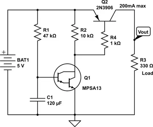

Failing any of those, something like this might work:
Open it and simulate it. Should get results like this:
Delay1
Delay2
An alternative could be something like this, but it might be a lot more finnicky. The SCR used is not ideal for this purpose and the model may be only so-so quality, so definitely experiment for best results:
SCR power delay
