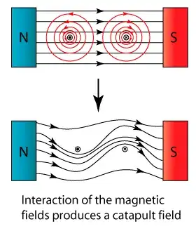

The problem here is that as the rotor spins, the interaction between it's magnetic field and the stator's cause the fields to distort and move from their normal non-rotating positions. The faster it spins, the more the fields distort. The best picture I could find of this phenomenon actually comes from the Wikipedia article on brushed DC motors. The the principle is the same for brushless:
distorted magnetic fields
By advancing the timing, you are ensuring that commutation occurs when the two fields are at 90° to one another in order to maximize torque production at maximum speed. However, since the position of the fields will change with speed, this timing advance is only good for one particular speed in one particular direction. For all other speeds your efficiency will be less than optimal at the angle between the two fields decreases from 90°. And for the reverse direction, you will be much less than optimal requiring much more current to produce the same amount of torque.

As current passes through the coil, it causes a generated magnetic field around the wire. As the generated magnetic field interacts with the static magnetic field, their forces push on one another and the fields distort:
field interaction
As the coil rotates, it moves in and out of the magnetic field. When the wire is in the magnetic field, the field distorts. When the wire is out, the field snaps back to normal. This snapping back take some amount of time. As the coil rotates faster and faster, the field has less time to snap back to normal. So the faster the motor turns, the more distorted the field remains.
