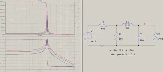

I've been doing an experiment which involves measuring the voltage across the capacitor at different driving frequencies. Consider the circuit below: enter image description here
A sketch of the experimental curve \$(R_1<R_2<R_3)\$ with $(L,C)$ constant:enter image description here

Also, I have been given the amplitude of the resonance peak: $$A=\frac{k}{\sqrt{(\omega^2-\omega_0^2)^2+(\gamma \omega)^2}}$$ where \$k\$ is some normalisation factor, \$\omega=2\pi f\$ and \$\gamma\$ is the damping coefficient. For \$A\$ to increase with \$R\$, am I correct to assume that \$\gamma \propto \frac{1}{R}\$? Is there a differential equation to describe the circuit?
EDIT: The internal reactance of the voltage source ~\$ 600 \Omega \$, \$(R_1,R_2,R_3)=(1\Omega, 2\Omega, 3\Omega)\$, /$L=1mH, C=100nF$/ I obtained the folliwing differential eq.: $$\ddot{I}_{LC}(t)+\frac{1}{L}\frac{R_{output}R}{R+R_{output}}\dot{I}_{LC(t)}+\frac{I_{LC}(t)}{LC}=\frac{RV_0 \omega cos(\omega t)}{(R+R_{output})L}$$, where \$\omega\$ is the driving angular frequency and \$V_0\$ is the peak driving voltage. This means \$\gamma=\frac{R_{output}R}{L(R+R_{output})}\$ even if the output resistance is taken into account, but wouldn't higher R lead to higher \$\gamma\$ and hence lower amplitude?

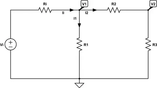

Well, we are trying to analyze the following circuit:
When we use and apply KCL, we can write the following set of equations:
$$\text{I}_\text{i}=\text{I}_1+\text{I}_2\tag1$$
When we use and apply Ohm's law, we can write the following set of equations:
$$ \begin{cases} \text{I}_\text{i}=\frac{\text{V}_\text{i}-\text{V}_1}{\text{R}_1}\\ \\ \text{I}_1=\frac{\text{V}_1}{\text{R}_1}\\ \\ \text{I}_2=\frac{\text{V}_1-\text{V}_2}{\text{R}_2}\\ \\ \text{I}_2=\frac{\text{V}_2}{\text{R}_3} \end{cases}\tag2 $$
Substitute \$(2)\$ into \$(1)\$, in order to get:
$$ \begin{cases} \frac{\text{V}_\text{i}-\text{V}_1}{\text{R}_1}=\frac{\text{V}_1}{\text{R}_1}+\frac{\text{V}_1-\text{V}_2}{\text{R}_2}\\ \\ \frac{\text{V}_\text{i}-\text{V}_1}{\text{R}_1}=\frac{\text{V}_1}{\text{R}_1}+\frac{\text{V}_2}{\text{R}_3} \end{cases}\tag3 $$
Now, we can solve for \$\text{V}_2\$:
$$\text{V}_2=\frac{\text{R}_1\text{R}_3\text{V}_\text{i}}{\text{R}_\text{i}\left(\text{R}_2+\text{R}_3\right)+\text{R}_1\left(\text{R}_\text{i}+\text{R}_2+\text{R}_3\right)}\tag4$$
