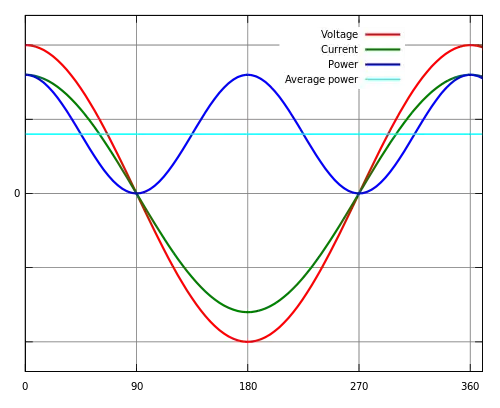

It's important to remember the difference between instantaneous power and average power. A 1 ohm resistor with 1 VRMS AC across it will dissipate an average power of 1 W, for instance, but the instantaneous power will vary with the waveform:
average vs instant power for a resistive load

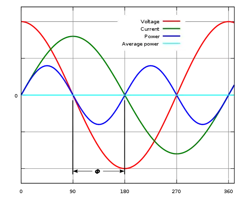

With a reactive element (capacitor or inductor) as the load, the power will fluctuate between positive and negative as energy flows in and out, but the average will be zero:
average vs instant power for an inductive (i think) load

  • In the image you posted, the average power seems to be non-zero... so where is all this power going? – Thomas O Oct 19 '10 at 14:54
    That's a resistive load. The electrical energy is being converted into heat energy. Energy flows, power doesn't. Power is the *rate* at which energy flows. – endolith Oct 19 '10 at 14:55

    So the power figure is the power the capacitor is supplying? What happens when the power figure is negative, is that the power it is consuming? – Thomas O Oct 19 '10 at 11:46
    On average, a capacitor can't supply power. In an AC circuit, a capacitor can supply power during part of the cycle, but only because it absorbed power in the previous half of the cycle. – JustJeff Oct 19 '10 at 16:39
    In the case of your example, yes, the power is fluctuating between positive and negative because the capacitor is alternately absorbing and then supplying energy. – endolith Oct 19 '10 at 19:21
