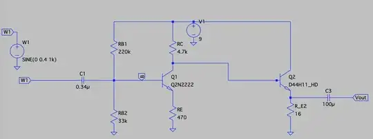

I am trying to design an amplifier for a 1 W 8 ohm speaker for educational purposes. The idea is to start from a common emitter amplifier to amplify voltage and then add a common collector (emitter follower) amplifier to amplify power and deal with impedance matching. I am a mechanical engineer and I am just learning about electronics so please bear with me.
The first step seems to work fine. I have sized the various components following this tutorial. I assumed a required gain of -10.

Now I would like to add the second stage (common collector) and I came up with this:
Enter image description here

The choice of the 16 ohm resistor was dictated by the the input impedance for the common collector Zin = beta * RE_2 (is this correct?)
If now I add a load RL = 8 ohm after the Cout capacitor I have the following Vout and current across it:
It is clearly not enough to drive the speaker. Of course I am missing a few things, but the purpose of this exercise was to start small and then build my way up.
  1. Can I actually build an (educational) amplifier with this approach?
  2. Do I need to increase the gain of the first stage and change the transistor?
I could buy a pre-designed kit of course, but what's the fun with that...

    You will want your output stage to be 2-quadrant for the speaker. An emitter follower won't cut the mustard. (Not without crazy-stupid wasteful values for the emitter pull-down of your emitter follower stage, anyway.) Your emitter follower can pull up, actively. But the only thing you have to pull back down is that resistor. And it's not really strong enough for the job. (It's just a passive device, after all.) Finally, I'd recommend learning about bootstrapping -- for your 1st stage as well as the output stage (which won't be an emitter follower, I hope.) Good work, despite some issues! – jonk Nov 13 '20 at 08:24
  • The new darlington version seems to be able to feed 2 Ohm resistor. Everything it gets is dissipated and the massive idle DC through Q2 will make it easily hot, too hot without cooling. I quess your speaker - if not some miniature type - can stand few hundred mA DC current. Reduce dissipation by having the speaker in place of RE2. –  Nov 13 '20 at 09:38
  • @user287001 How would I remove the DC component in that case? – Rojj Nov 13 '20 at 18:07
  • The whole suggestion was based on assumption DC can be tolerated. I have had as much as 500mA long lasting DC through a 8 Ohm speaker with no smoke. The speaker was rated for 5W continuous power. The DC caused only 2W dissipated in the speaker and it didn't pull the cone too near the edge of the available motion space. The speaker had DC resistance = 8 Ohm. –  Nov 13 '20 at 19:10
  • Adding any DC to a speaker is a bad idea, unless its a disposable speaker and the currents are very very low. – S.s. Nov 14 '20 at 03:42
    @Rojj Also look [here](https://electronics.stackexchange.com/a/368660/38098) and [here](https://electronics.stackexchange.com/a/503581/38098). About \$1\:\text{W}\$ into \$8\:\Omega\$. Class-A, which is slightly less complicated. The [LM380](https://electronics.stackexchange.com/a/273901/38098) is about 2.5 watts. (Also see [here](https://electronics.stackexchange.com/a/281838/38098).) That should be enough for now? – jonk Nov 15 '20 at 07:07
  • @jonk Wow! That's certainly enough :-) Thanks – Rojj Nov 15 '20 at 08:18
    @Rojj The 2nd link in my comment probably has most of what you need for class-A. The LM380 provides you with a class-AB arrangement (lower wasted dissipation) that is fairly typical. Best wishes!! – jonk Nov 15 '20 at 08:22
Yes, this is absolutely the right approach to take when learning about electronics.
In software, they have a mantra that it's easier to get correct code to run fast, than it is to get fast code correct.
Similarly with hardware, walk, before misguided people who have been there, done that, know it all, and have forgotten how hard it was at the beginning, suggest you run.
Your circuit will work. It won't work very well, it won't be very power efficient, but it will work, and the performance of the hardware should pretty much match that of the simulation.
It's by building a circuit like this that you learn why no commercial amplifiers use an RE_2. Once you understand what everything is doing, then replacing it first with a current source, and then the bottom half of push-pull output, will become meaningful. The progression to a push-pull output stage is a whole can of worms (biassing, cross-over distortion, thermal stability), so I'd save that for a lot later).
But before you do either of those to the output stage, there's a lot you can, and should, learn about basic amplifiers with what you have there. For instance, bypassing part of RE with a capacitor to change the first stage gain.
Happy learning. Take it slow. Don't try to run before you can walk, which may lead to discouragement.

You can implement an excellent class A amplifier (with no crossover distortion) this way.
The second stage (your buffer) must be a Darlington transistor, so its Rin becomes quite high (>> 10 kohm) and thus your gain of stage_1 is rather accurate at Rc/Re.
Another challenge is biasing.
I've often used DC_feedback from output emitter of the stage_2, back to the base of stage_1.
To do this, directly operate stage_2 base from collector of stage_1.
The key is a 2_resistor 1_capacitor DC_feedback from output emitter to input base.
Use two series resistors and a midpoint shunting capacitor.
  • Ground the capacitor (this will be polarized capacitor), (-) to ground; call the (+) the Vbias; use 100 µF as a starting value
  • remove your existing (two) biasing resistors on base of Q1
  • run a 10 kohm resistor from base of Q1 to Vbias node
  • run a 100 kohm resistor from the Vbias node to the output emitter
With the DC_feedback capacitor (100 µF) initially having no charge, the collector of Q1 will be initially at VDD, which causes a brief burst of high current through your Darlington transistor, and a loud pop from the speaker.
With Q1 needing about 1 milliampere collector current, and about 10 µA base current, there will be 1.1 volts drop across the (10 kΩ + 100 kΩ) feedback network. Thus the input base will be 1.1 volts DC lower than the output emitter.
You can adjust this as (if) you wish.

As mentioned in the comments, indeed a single-transistor output stage to drive an 8 ohm speaker isn't such a good idea, it can be done and it will work it will give you disappointing performance (low volume and distortion when you raise the volume).
Instead I suggest that you build a "Class AB push pull" stage as described in many tutorials. Here's one that should be helpful.
..and deal with impedance matching.
That's a common misunderstanding among beginners. Even though audio amps often state that they have for example an "8 ohm output" that doesn't mean that they are impedance matched. What that means is that the stage is designed to drive an 8 ohm load. The voltage and current the stage can deliver is optimized for an 8 ohm load.
In reality an audio amplifier output is designed to have a very low output impedance so that it behaves like a voltage source. The Class AB push pull stage comes close to that behavior.
Impedance matching where input and output impedance need to match is usually only needed in high frequency circuits, not in audio circuits as the signal frequencies are much lower.
