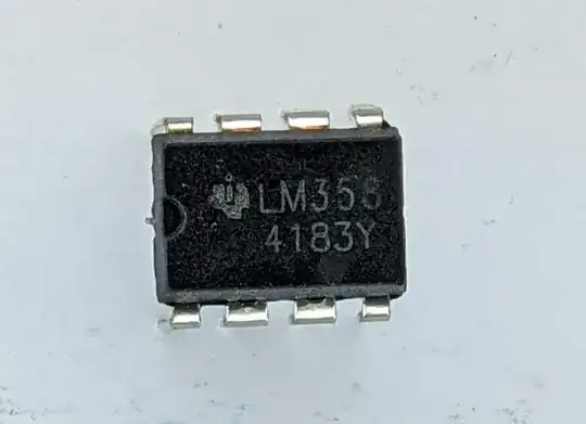

Image of one of the LM358s I'm measuring.

    Are you sure it's actually an LM358 and not, say, an LT1358? Were the parts acquired via franchised distributors? – Spehro Pefhany Nov 11 '20 at 19:50
    Can't say where these op amps came from now. Probably bought in bulk from an ebay seller years ago. Adding a picture in case it helps identify a fake. – Sam Gallagher Nov 11 '20 at 19:58
    The TI logo doesn't look right. – vofa Nov 11 '20 at 20:36
    Here's a photo of a TI chip that is genuine: [74LS590](https://i.stack.imgur.com/bHA1y.png). (Don't have any LM358s handy.) – jonk Nov 11 '20 at 20:37

Given the dubious eBay source and somewhat dodgy markings, they're probably something similarly cheap like TL071 remarked.
Suggest you discard them and get known parts from a reliable source.
Real clone LM358s are 2.8 cents apiece in 1K from LCSC, for example, and ON ones are only slightly more.

    Pulled some 358s that I knew were genuine, and the measured slew rates were 0.6 V/us or so. Grabbed some TL072s, slew rate matched 18 V/us. I'd certainly say this makes for a convincing picture! – Sam Gallagher Nov 11 '20 at 20:42

    Looking at the photo in the question, this seems like a clearly blacktopped part. It looks like there is a bit of the black paint flaking off just below the "83" in the bottom row, plus the inner edge of the round dent seems to be "rounded off" with paint as well. – TooTea Nov 12 '20 at 10:49
