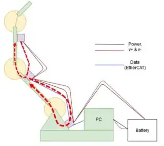

I added a diagram as requested with maybe some clarification. The green 'frame' is electrically connected (green lines represent the connection) and the purple boxes are motor controllers creating some noise when powering and moving the motors represented by the yellow circles. The data cables are shielded EtherCAT cables.

  • We can't see your schematic so it's unanswerable without you providing more information. An example of what you are talking about as a diagram would be a good start. – Andy aka Nov 11 '20 at 15:31
  • Frames of some size are usually connected to earth. It's not good practice to mix earth ground and system ground. (Thought opinions differs about this.) If each cable shielding are connected together and then connected to system ground, it should work. Maybe adding a parallel wire for system ground to offer additional anchors to the shields could improve the circuit. – Fredled Nov 11 '20 at 22:11

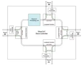

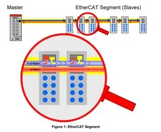

In EtherCAT the signal processing chain is digitized and goes through an EtherCAT slave controller or equivalent on every single device.
EtherCAT Network Topology courtesy of Beckhoff
Therefore, The Daisy chain topology of EtherCAT is not actually a physical daisy chain and does not resemble a traditional bus interface of E.G RS485 or CAN.
Signal processing chain inside the slave device, note that up to 4 ports are allowed allowing for a star topology, but typically 2 are seen on devices, the ethernet frame processing occurs in the "EtherCAT processing unit" between the input port and any subsequent network segments. Courtesy of Beckhoff

If the shield is tied to both locations at the "purple" boxes, It does create a ground loop in the shielding (as the red arrows show below). Check to see if the shield on the cable is actually tied to the connector. It would be unlikely that this would be the case, since ethercat or ethernet cables do not have a shield that connects to the housing of the connector. However, this may not be a problem for several reasons:
  1. There needs to be a changing magnetic field, otherwise no current will be generated
  2. The majority of the magnetic field needs to be perpendicular to the loop (if it is parallel no current will be generated). The loop area also needs to be large enough to generate a sufficient current.
  3. Even if there is a current generated in a shield, it's only a problem if the signal inductively couples to the inner conductors
  4. Ethercat uses a design with differential pair and common mode transformers that is immune to common mode noise, and is the best reason for why you probably won't have problem with this design. Even if a large shield current did couple from the outside of the shield to the inner conductors, it would be the same for both conductors and would be canceled out.
In short you should be fine using ethercat for a comm system which is isolated and prevents ground loops (but not on the shield). Coupling should be low

This is one of my favourite topics :) You have to understand where what current flows. I usually divide things into three categories:
  1. DC - you only want to flow on your power lines, hence you will only connect your GND to the shield at one point.
upd: why would you connect it even once? Because the frame is the safe spot to touch, it's grounded to the building PE (well, it should be), and for safety reasons, you will want your connectors to be safe- because you can touch them.
  1. Low AC (for instance, anything up to a few hundred kHz)- this you want to keep inside your motor drives. Use line filters on the power lines, and you are safe- just be sure you have enough capacitance, so the current will not cause high voltage ripples.
  2. Higher AC- usually in these systems it's anything between 1MHz to 100MHz. This crap is generated by motor drives, can easily flow through air to the shield and cause a lot of trouble. This is why you will want to have a good "contact" in the AC domain between cable shields and the frame, also between GND and the frame everywhere. This is what you do with capacitors- normally pairs of 10nF and 1uF. Just be careful, safety and other issues may require special capacitors.
Basically, this is a simple grounding policy that you can use. I usually draw every current on the system diagram to try and find where it can go.
Remember, you don't want a motor AC interference to go to communication cables. If it finds its a way- you have to provide a "better alternative", to a route with lower impedance towards the frame. Usually, it means capacitors in parallel, ferrite beads and chokes in series with the cable.
