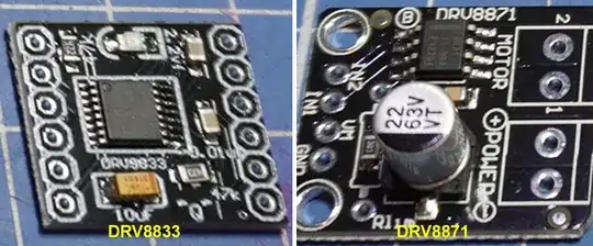

  3. Module pins were soldered by a not very experienced hobbyist and therefore module might be damaged
op drv8833

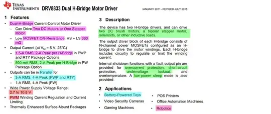

drv8833 spec summary

(a) Product sheet of the assembled breakout module to get a rough idea of the power requirements and function of the pin outs (which might be different from the chip datasheet.
(b) Datasheet of the chip, to get a rough idea of what external components are used to assemble the module.

(2) DRV8833 Dual H-Bridge Motor Driver - TI 2011/2015 (The datasheet of DRV8833 by TI)

Appendix B - TaoBao/AliExpress DRV8833 Motor Driver Testing Notes
taobao drv8833 product
taobao_drv8833 module pin out

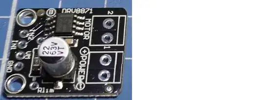

Using it is super simple. Connect your motor to the OUT terminal block. Power the board with 6.5-45VDC power on VMotor and provide the H-bridge input control on IN1 and IN2. You can even PWM the inputs and the driver chip will do the right thing.
You can set the current limiting with an external resistor Rlim. We solder in a 30K resistor by default for a ~2A current limit, however you can remove this resistor and/or solder a resistor over it to change the resistance and change the limit. - Lady Ada
