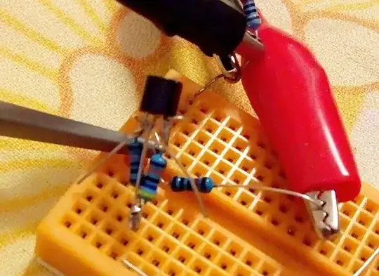

I've built a few Vbe multipliers as cheap temp sensors. I know there are better ways to sense temperature but I am not interested in accurate measurements, and my question is exclusively about a strange behavior (oscillating/irregular voltage readings) I've witnessed the day after one of the worst built probes fell into boiling water.
One of the sensors, a 5x multiplier with resistor values 100k and 470k, was built with very thin wires (cat 5e), the wrong insulation of the transistor's pins and inadequate heat-shrink wrap. (In my application I intend to seal them with resin or even silicone but, again, that's irrelevant). The following picture shows a drawing of how I assembled the sensor and a picture of the sensor taken after it had fallen in boiling water (it was not supposed to fall in its entirety into the water):
(Bad) thermal probe
As you can see the insulation does not look waterproof at all, and I am sure that boiling water did not help in making it better. (My other probes have better insulation with insulating rings on collector and emitter pins, not the base, and thicker wires)
I used an unmarked PNP with an hFE of 370 and a Veb of 0.71V @18°C.
The circuit was connected to a regulated 5V power supply via a 10k resistor, and the voltage was measured between emitter and collector in order to get a positive reading. This is the schematic with inverted voltage Vout and a known transistor:
Veb multiplier
Now, during 'calibration' at ambient temperature in air I saw the voltage allowed for reasonably accurate and fairly reproducible measurements (shown as blue dots in the the next graph)
16.8 °C 3.547 V
16.9 °C 3.545 V
16.3 °C 3.552 V
16.2 °C 3.557 V
But when I dipped the probe in boiling water it fell fully in - so that tap water reached the terminals and funny things started to happen.

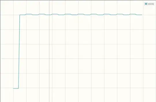

Part 2: badly insulated probe meets oscilloscope
(added after reading the first comments and answers)
I was able to reproduce the effect after dipping the sensor in boiling water, taking it out and leave it alone for a few hours. But let's follow the chronological order: before its new encounter with hot water after more than two weeks, the measures were always stable and the sensor basically flatlined on the scope. This is what happened the first time I dipped it into hot (not exactly boiling) water: a nice and smooth voltage variation
smooth variation
Evidently water had yet to creep inside. I repeated that a few times and the sensor appeared to work smoothly, until...
This is what happen with the fourth bath (I printed the screen while still scanning):
no longer monotonically adapting
The voltage goes up and down while in the hot water. This is not the effect I was curious about but it shows that something odd is happening that should not be happening with an insulated sensor.

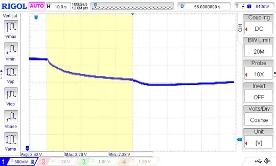

Another 'anomaly' I saw after that, immediately after an hot bath is the voltage keeping going down for a while after exiting the water, before rising again:
Still going down when out of the hot water
The sensor does not have enough thermal inertia to account for that. And then I saw sudden jumps in the voltage while cooling in air
sudden jump in voltage
I also witnessed wild variations when touching the probe and for several seconds after that, probably due to the water moving inside. This is one of the screenshot that shows the variation during touch ending with the dashed line, and then the voltage keeping its downward trend before rising again as expected:
dip after touch

I have built another probe, but this time it was 'naked' so that I could drop water on the terminals to observe the effect. This is a picture of the probe:
Naked probe

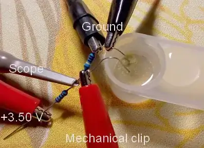

Part 4: Taking the transistor out of the equation
I wanted to see what happens without the transistor. I created a voltage divider with two resistors (220 ohm and 1 megaohm) supplied with 3.5 V regulated. Then I placed the two terminals of the 1 meg resistor into a small water vessel, in order to show how the voltage across it changed on the scope's screen, like this:
voltage divider loaded with liquid resistor
With just tap water the voltage started to decrease very slowly. Adding a bit of salt to the solution made the voltage drop faster, as expected, but no irregularities were observed:
gradual reduction in conductivity
stirring the solution caused sudden jumps and the occasional irregular jump, even several seconds after the stirring had ended. But things went 'Crazy Ivan' when bubbles and electrolysis deposits began to accumulate, as hypothesized by Brian Drummond. Here is the wild variation I observed
Crazy Ivan
when the solution was this kind of mess:
Bubble bubble, toil and trouble
I also observed jumps when moving the bubbles around with a toothpick, and also an interesting sensitivity to vibrations (which I do not document here because this post is already toolong).
I believe I can assume the solution proposed by Brian Drummond was spot on: bubbles develops due to electrolysis and that changes the conductivity of the solution in a vaguely periodic fashion as they are produced, grow, and burst. I wonder if the metallic residues that were dissolved into the solution play a role as well, especially in its interesting susceptibility to vibrations.
