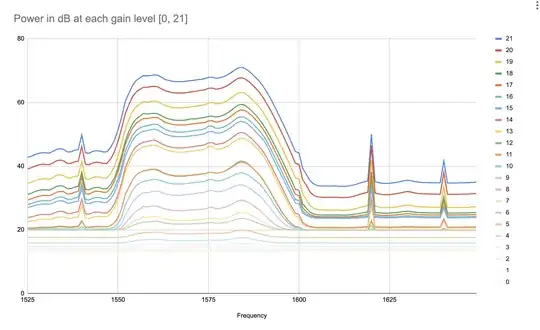

Also, I measured the power over 1525-1650MHz, with various settings for the SDR gain. You can clearly see that LNA noise over the noise floor of the SDR.
RF Power

  • Thank for suggesting this. I spent a while measuring the power getting to the SDR with a variety of gains. As you predicted, beyond ~3dB above the noise floor, adding more gain does not significantly increase performance. Unfortunately, I am still unable to detect weak signals; I can only see a single satellite while my handheld GPS (with the same antenna) tracks >8. In the measured spectrum, I noticed a couple of spikes spaced 20MHz aparts. Perhaps there is some LO leakage? Can you take a look? [shorturl.at/suEKN](link) -- I am not sure if this is something to be worried about. – Manuel Menzella Nov 11 '20 at 04:57
  • Nice work! It looks like there's plenty of external gain, the filtered LNA noise is clearly visible. (do paste a graph into your question). You should probably choose a fairly low gain on the airspy. Is your conversion to 1 bit done right? Could there be an LO/DC issue with the SDR tuned right on 1575.25? The spikes aren't good and might dominate in the signal when you have just 1 bit, maybe you need to filter them in 8bit land, then convert to 1bit? Have you read all of gnss-sdr.org for clues? – tomnexus Nov 11 '20 at 07:13
  • Looking at your graphs again: 1) the external LNA does seem to overpower some of those spurs within your sampling band, does that help? 2) Can you repeat the wide scan but with slightly different tuning settings, to see if the spurs move or not. – tomnexus Nov 11 '20 at 12:39
  • Thanks! I tried a bunch of possible gains, but they all result in a single satellite being detected. I am not only doing the correlation on the 1-bit signal -- I am also correlating the PRN codes on full 16-bit signal, which still detects just a single satellite. At this point, I'm starting to think that perhaps I need a less noisy SDR. What do you think? Also, the spurs remain on exactly the same frequencies even when using different IFs on the SDR; this rules out spurs, doesn't it? They also appear with just a 50-ohm terminator on the SDR. – Manuel Menzella Nov 12 '20 at 04:10
