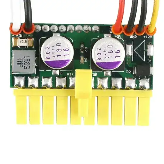

Mini-Box picoPSU-120
You can get very small DC-to-ATX power supplies - like the 120 watt 'picoPSU-120' pictured. Takes a 12v input and outputs +12v, -12v, +5v and +3.3v right on the ATX connector.
Of course, if you need more than 120 watts, or if you want isolation, you'll need something proportionally larger. But while 120W may not run a big gaming rig, the latest USB-C-powered Macbook Pro consumes less than 100W even when charging.
The converter you linked is the size of a standard PSU so it fits in the space in your case for a standard-sized PSU.
