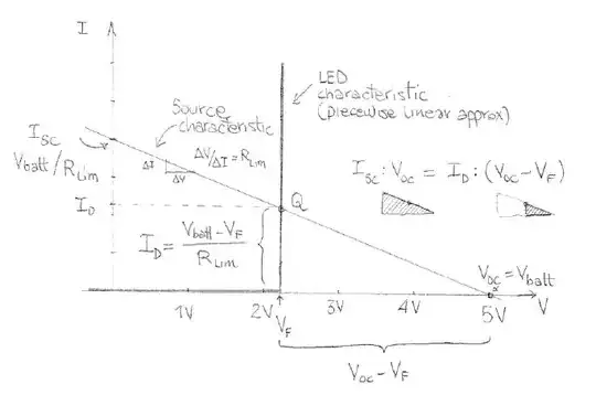

I believe you might benefit from the visual aid associated with the use of load lines. Try to see your circuit as the combination of two one-port elements: the generator and the load. Each of these one-ports will have its own Voltage-Current characteristic and when you combine them together,by connecting the respective ports, you end up in sharing both voltage and current.
Note that it is customary to adopt two antithetical conventions for the sign of the current: in the case of the source, the current is exiting the one-port from the point at higher potential, whereas for the load the current is entering the one-port from the point at higher potential (where the + is or the voltage arrow has its point in the non-German convention).
source and load characteristics
Now, since both one-ports share the same voltage V and the same current I (here the choice of current convention shows its usefulness), the operating point of the circuit falls on the intersection of the two characteristics curves.
operating point as intersection of source and load characteristics
You can ascribe the description each port V-I characteristic to the application of a generalized form of Ohm's law (allowing for nonlinear and active elements), while the relationship between the electric variables of the ports established by their interconnection can be seen as an application of Kirchhoff voltage and current laws.
Let's see what this entails by analyzing some simple circuits where we connect a diode to different kinds of sources. In all the following circuits, the load will be a diode (an LED, if you will) which is basically a nonlinear resistor with an exponential V-I characteristic.
Let's start with an ideal voltage source. The V-I characteristic is a vertical line at \$V_{batt}\$, meaning the generator is capable of providing the same exact voltage \$V_{batt}\$ no matter the current drawn by the load. If the value of \$V_{batt}\$ is sufficiently higher than the 'nominal' threshold voltage of the diode, the intersection of the generator and load characteristics will be at the point (Vq, Iq) where the current Iq is high enough to destroy your diode.
Ideal Voltage Source
Ideal voltage sources do not exist in real life, and any source you will find will exhibit an internal resistance \$R_s\$ that will cause the V-I characteristic to bend towards the I axis. The intersection of the source characteristic with the I axis is the short circuit current \$I_{sc}\$ (not shown in the following picture because it's way up on the I axis). In some cases the combination of the open circuit voltage \$V_{batt}\$ of the source and its internal resistance \$R_s\$ might cause the intersection of source and load curve to happen at a point (Vq, Iq) with low enough current not to destroy the LED.
Internal resistance might be enough
This is the case for example of those silverish button cells: you can safely attach an LED to them without any additional limiting resistor. But with most other voltage source - unless they are regulated by other means around the nominal threshold voltage of the LED, you will usually end up killing the diode.
So, why not take control of the situation and use a series resistor \$R_{lim}\$ in order to limit the value of the current to a safe value? This is the easiest way to power a LED (a better way would be to use a current source). Usually this series limiting resistance \$R_{lim}\$ is much higher than the internal resistance \$R_s\$ of the source so that the latter parameter can be safely ignored. The 'limited' source characteristic would bend even further toward the I axis and the intersection of source and load lines can be made to happen at a predetermined point (Vq, Iq).
Limiting series resistance
Given the shape of the exponential diode characteristic (here not drawn to scale), the value Vq won't stray too much from the nominal threshold voltage \$V_{\gamma}\$ (or \$V_{threshold}\$) of the LED, but the important thing is that by adding a series resistance \$R_{lim}\$ we gained control on the otherwise wildly variable value of the current.
The mathematics to determine the exact value of the intersection of the linear load line with the exponential diode curve, while still being basic calculus, is not exactly elementary (you might be required to add the Lambert W function to your vocabulary) and it is customary to resort to numerical or graphical approximations as shown in some of the other answers.
(These approximations amount to swap the nonlinear exponential curve with a piece-wise linear curve either rising vertically at \$V_{\gamma}\$ or slanted with a slope determined by the diode's differential resistance \$r_d\$)
From a qualitative point of view, though, you can appreciate the role played by the limiting resistor by drawing the V-I characteristics of the source for different values of \$R_{lim}\$:
Variable limiting resistor
As you can see, by increasing the value of \$R_{lim}\$ you bring down the operating point(Vq, Iq) at lower and lower values of the current. Note that for a given, set, fixed value of \$R_{lim}\$ the current is the same for all series elements (source, limiting resistor and LED) but if you change \$R_{lim}\$ (by either swapping the resistor, or acting on the knob of a potentiometer, or even by changing its temperature by blowing hot air over it) you will see the current change in all elements of the series.

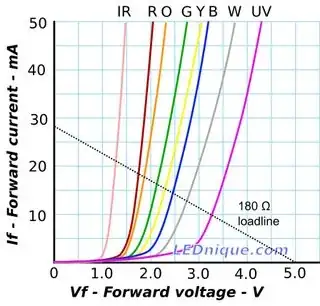

What Determines Vf?
The Vf threshold depends on the color of the LED and its exact material formulation. In general, the shorter the emitted wavelength, the higher the LED Vf threshold.
LED I-V Characteristics For Different Colors
From here: http://lednique.com/test-equipment/testing-unknown-leds/
The datasheet for the specific LED you are using will include this I-V curve data. This, in turn, helps solve the rest of the current-setting dilemma.

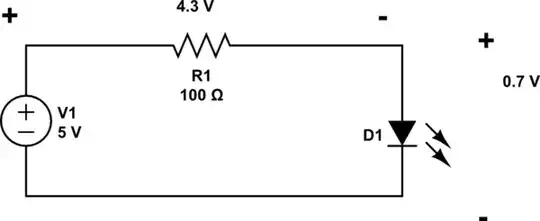

A diode conducts current if it is in forward bias. The diode is forward biased when the voltage drop across it is equal to it's forward voltage. If the diode is forward biased, then the voltage across won't go any higher.
A silicon diode usually has a forward voltage of \$V_{\text{fwd}}=0.7 \text{V} \$. Let's look at your circuit without the resistor, and assume that the diode is a silicon diode.
From inspection the diode is in forward bias (if this is not clear I can elaborate), meaning that the voltage across the diode is \$0.7 \text{V} \$.
Because our voltage source provides \$5 \text{V} \$ there must be a voltage drop of \$4.3 \text{V} \$ across the resistance in the wire, due to KVL.
A wire has very low resistance (in the magnitude of micro-ohms). Let's set the resistance of the wire to \$0.1 \text{m}\Omega \$. Using Ohm's Law the current is \$I=\frac{V}{R}=\frac{4.3 \text{V}}{0.1 \text{m}\Omega}= 43000 \text{A}\$ (!!!!!!!)
Due to KCL, this current also runs through the diode and the voltage source.
Such ridiculously high current will obviously destroy your components. We don't want this to happen, so we introduce series resistance to lower the current.
simulate this circuit
There is still a voltage drop across of \$4.3 \text{V} \$, but it is now across a much greater resistance, than the resistance of the wire. Using Ohm's Law now the current is \$ I=\frac{V}{R}=\frac{4.3 \text{V}}{100\Omega}=0.043 \text{A} = 43 \text{mA}\$
Due to KCL, this current also flows through the diode and the voltage source.
This current is significantly lower than before and, depending on the ratings of the diode, won't damage any components in the circuit.
