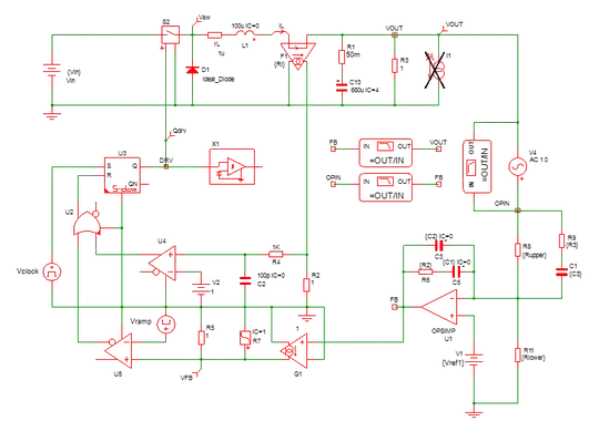

I am working on a buck converter and I want to obtain the Bode diagrams of the open-loop circuit. The below circuit is what I made. However, the DC-gain is -96 dB while it should be very small around -6 dB according to the transfer function. So, am I missing something? Could you please help me out with this?
circuit and Bode diagrams of the output (open-loop transfer function)

The AC analysis is a linearized analysis. That means it simulates the small-signal behavior of each element at its operating point.
In the case of the switch, that means it is held in either the on or off state, and behaves as a resistor with either the ROFF or RON value.
The -96 dB transfer gain is due to the leakage through the switch's 1 megohm off resistance.
If the reason you're simulating this circuit is enable designing the switching control loop, really you should just remove the switch and diode and drive the left end of the inductor with your voltage source. Because the control loop critical frequencies will be much lower than the switching frequency, the whole switching circuit (input source, switch and diode) just looks like a voltage source with a value depending on the switch duty cycle when you're designing the control loop.

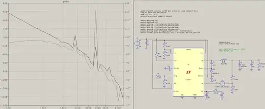

I'll show you two other methods that can be done in .TRAN.
One of them is found in the LTspiceXVII/examples/Educational/FRA folder, in My Documents, as part of the default installation of LTspice(XVII). This method implies setting up a literal small-signal source, which is the equivalent of Middlebrook's LTspiceXVII/examples/Educational/LoopGain.asc and LoopGain2.asc, but for .TRAN.
Among the three shematics in there, Eg2.asc shows how to setup a frequency sweep in .TRAN and some .MEAS scripts in order to extract the frequency information. It's all done with an LTC3611, but you can implement it easily in your schematic like this:

Note that I've made a few changes compared to the original schematic: freq sweep is from 50k to 500k, with 50 steps per decade, not octave. The option nomarch is also added.
