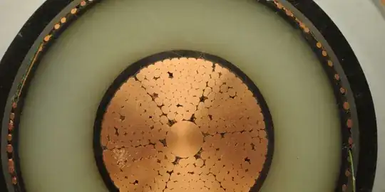

Sample cable : image from https://www.dnvgl.com.ar/ enter image description here
  • *Copper* wires? That's a surprise. Normally it's only used inside homes for the little stuff. Power distribution is almost exclusively aluminum - it's twice as good a conductor (by weight, which is what you care about when you're building power pylons). About 12x as good by $$$. – Harper - Reinstate Monica Oct 27 '20 at 16:29
  • Why selectively remove only commonly used units in wiring, but not miles? – Harper - Reinstate Monica Oct 27 '20 at 19:24
  • It may be that Cu is preferred for subsea and/or buried cables, with Al (+ probably a steel strength member) for overhead. The Chinese article mentioned cross section but not material; as it seems to be overhead; I don't know if they used Al. –  Oct 27 '20 at 19:35
  • I wonder if capacitance is the reason on these crazy high voltage underground/sea cables, a large CSA means a larger diameter which means more capacitance for a given insulator thickness. Capacitiance in DC systems is less of a problem than in AC systems, but it may still be inconvinienient to have too much of it. – Peter Green Oct 27 '20 at 20:52
