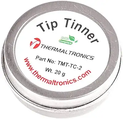

Solder is the answer, but you need to make it stick, first.
The best product I have found for this is called Tip Tinner. It looks like this:
I use it every time I heat up the iron, then wipe it off on a damp sponge. Then after use I put a tad more on it as I shut the iron off.
