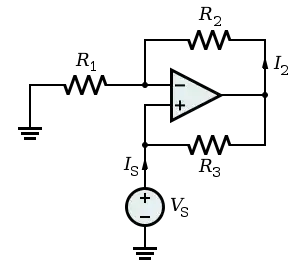

According to this, if \$R_1=R_2=R\$ then input resistance is \$R_{in}=-R_3\$, and if we assume that op amp is ideal. So negative resistance is in parallel with voltage source \$V_s\$.
  • Am I understand this well, in this case ideal voltage source is acting as load and input resistance \$R_{in}=-R_3\$ is acting as generator?
  • So how is it possible that ideal voltage source \$V_s\$ which internal resistance is 0, acting as load?
  • If \$V_s\$ is a real voltage source with finite internal resistance, what impact on the voltage source, i.e. battery, will be in this case? Can we somehow destroy that battery with excessive current?

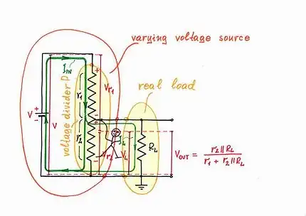

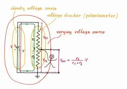

1. Voltage divider unloaded. This humble circuit of two resistors in series (or a potentiometer) supplied by a perfect voltage source (with zero output resistance) behaves as a "bad" voltage source (with some output resistance). But when it is not loaded - Fig. 1, its "badness" does not manifest itself and its output voltage is exactly as it should be.
Fig. 1. Voltage divider unloaded
2. Voltage divider loaded. The problem of the high output resistance is that when a load RL is connected to the voltage divider - Fig. 2a, it "sucks" a current IL and the output voltage VL drops.
Fig. 2a. Voltage divider loaded by a resistor RL
This phenomenon can be seen everywhere in our life - if living beings are loaded, e.g. by a heavy load (Fig. 2b), they bend.

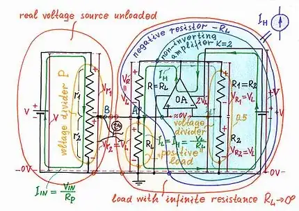

4. Voltage divider "helped" by INIC. In the end, all that remains is to implement this powerful idea through an op amp circuit - Fig. 4. It is simply a non-inverting amplifier (acting as the variable voltage source BH above) and a resistor R = RL in series to the op-amp output. This circuit is known as a "current-inversion negative impedance converter" (INIC).
Voltage divider helped - INIC
Fig. 4. Voltage divider "helped" by an INIC
The trick of load cancelling is clever but it implies the load is a steady resistor; the input voltage and the potentiometer can vary.

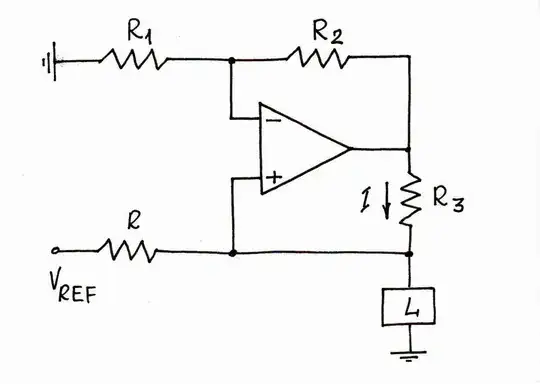

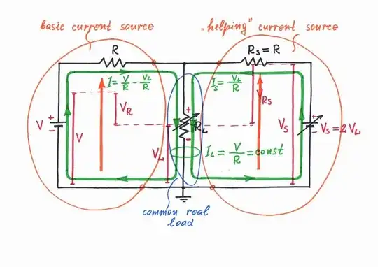

Example 2 : Howland current source
Another well-known application of this powerful idea is the legendary Howland current source aka Howland current pump - Fig. 5.
Fig. 5. Howland current source - classic circuit diagram
We can see in the conceptual circuit diagram (Fig. 6), that really the idea is the same - an imperfect current source (on the left) is "helped" by an additional current source (on the right) so that the load current stays constant when the load varies.
Fig. 6. The idea behind the Howland current source
The "helping" current source acts as a negative resistor with resistance -R that neutralizes the positive resistance R of the imperfect current source; so the resulting "internal" source resistance is infinite.
The operation of the Howland current source is visualized in Fig. 7 by voltage bars and current loops.
Howland current source visualized
Fig. 7. The operation of the Howland current source visualized
In contrast to the load canceller above, in the Howland circuit solution the load can vary. The negative "resistor" -R (INIC) neutralizes the steady "internal" resistance R of the imperfect current source.
