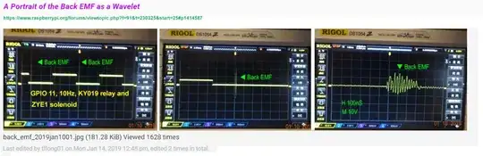

Appendix D - Detecting (Electromagnetic Buzzer) flyback voltage and current spike experiment
Detecting (Buzzer) flyback voltage and current spike experiment 1/2
Detecting (Buzzer) flyback voltage and current spike experiment 2/2
buzzer voltage spike
Appendix E - Buzzer Back EMF 30Vpp 100 ns Spike Wavelet Selfie
The voltage spike can be as scary high as 30Vpp, But the duration is small 100nS. If the human finger lightly taps/knocks the piezo disc, the mechanical energy transferred to the piezo disk should be of the same order of the 5V electromagnetic buzzer's little hammer hitting the bouncing steel spring bar. It is tedious to use my scope's one shot trigger to display my tapping of the disc. So I used the buzzer to display the repeatedly back EMF voltage spike. I did use my scope to zoom in the spike and found her a pretty little wavlet, so I took a selfie picture for her.
