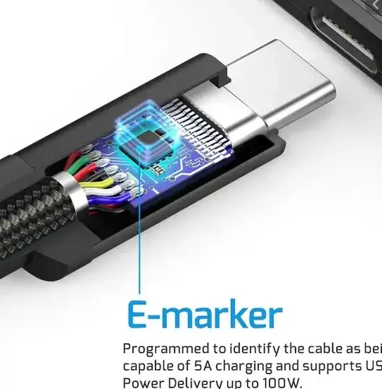

3. USB-C Cable
As outlined by this answer (and referenced to the USB-C documentation in the same answer) the cable use can limit the amount of power you can transmit. You will generally look for an EMCA enabled cable (see photo) if you want to exceed 60W. enter image description here
To wrap up, 3A at 20V is sufficient for your purpose. However, there is nothing to limit this module to 3A, which means it could provide up to 100W (20V/5A), as long as your AC/DC wall transformer allows it.
