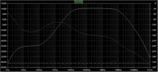

So, with the circuit I have so far, I get a semi-decent gain, a collector current that is a bit higher than the specification, and a frequency response that looks like this:
Tesla is rolling in his grave
I am using the built-in general model for the transistor so that's why there's no frequency cutoff (or is there supposed to be one and I just did something wrong?). With the 2N2222 transistor it looks like this:
My transient response looks good, though. It's symmetrical wrt to ground even though the negative portion has a slightly bigger peak amplitude by 0.3V.

All capacitors in your circuit will have an effect on the low-frequency cutoff your amplifier will have.
The \$C_1\$ and \$C_2\$ will form a classic high-pass filter.
And the corner frequency can be found using this equation :
$$F = \frac{1}{2\pi RC }\approx \frac{0.16}{RC}$$
Thus for the incut capcitor wil will have:
$$F_1 = \frac{1}{2\pi (R_{B1}||R_{B2}||r_{\pi})C_1}$$
I ignored the source impedance influence.
And for the output capacitor
$$F_2 = \frac{1}{2\pi(R_C + R_L)C_2}\approx \frac{0.16}{R_CC_2}$$
Now \$C_E\$ capacitor.
At DC the voltage gain is equal to \$ \frac{R_C}{R_E}\$. And the amplifer voltage gain will start to increses form \$ \frac{R_C}{R_E}\$ towards \$(R_C||R_L)g_m\$ at frequancy equal to: $$F_Z = \frac{1}{2\pi R_EC_E}$$
And the amplifier will reach this gain \$(R_C||R_L)g_m\$ value if the signal frequency is larger than: $$F_P\approx \frac{1}{2\pi \frac{1}{g_m}C_E}$$
Therefore, if we set for each individual filter cutoff frequency at 20Hz the overall lower cut-off frequency will be equal to:
$$F_C = \frac{F_L}{\sqrt{2^{\frac{1}{n}}-1}} = \frac{20Hz}{\sqrt{2^{\frac{1}{3}}-1}} \approx 39.2Hz $$
Thus, if you want the low cutoff frequency to be around \$20Hz\$ you need to select for example you need to set \$F_1\$ and \$F_2\$ at \$\frac{20Hz}{2...10} = 2Hz\$ and \$C_E \approx \frac{0.16}{1/g_m*20Hz} \approx 1600\mu F\$
G36
