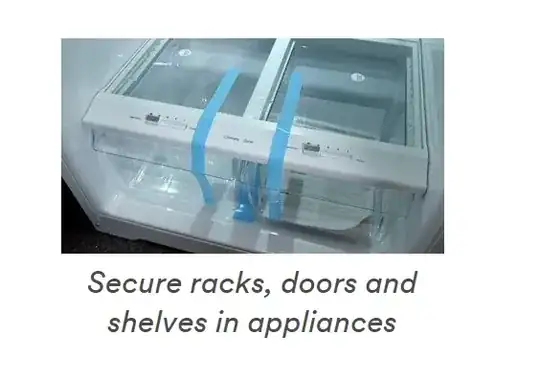

By holding electronics together, I mean to hold mechanical parts together for shipping such as flaps and other parts that can flop such as printers and scanners.
It's a very thick material that holds firm but always comes off easily. I've seen it in a variety of colors such as green, red, but most often in blue.

Probably clean-release/clean-removal strapping tape. Polypropylene with a rubber adhesive.
Eg. 3M 8896

It's called holding tape / blue holding tape / PET blue holding tape.
