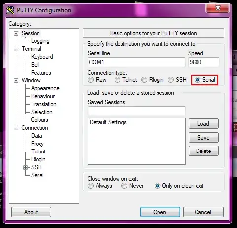

PuTTY, surprisingly enough, can act as a full-featured serial terminal. It supports full-blown VT-102/VT-80 command codes too.

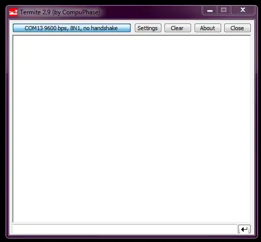

There is Termite, which is a very nice, no-installation 200K exe:

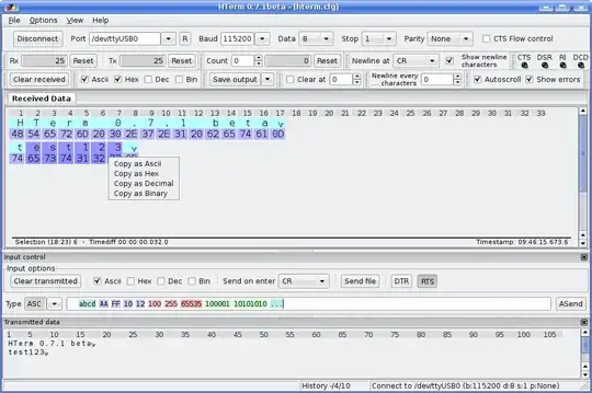

HTerm is a gem!
I highly recommend you give it a try. While not being a pure terminal, it supports some nice features like (optional) concurrent display of Ascii, Hex, Dec and Bin. Its very straightforward to use and consists of a single exe file without any special dependencies.
I've used this on WinXP and Win7 without problems.

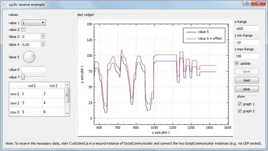

I use ScriptCommunicator. It has many features and a very useful script interface: http://sourceforge.net/projects/scriptcommunicator/
main window:
example script GUI:
