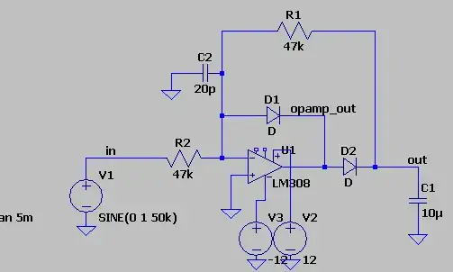

I am having trouble building this precision half-wave rectifier to use to detect an AC peak on a real PCB:
The "real" circuit uses an LM318 opamp, but in LTspice the LM308 appears to replicate the problem ok.
The problem I am having is the output opamp_out, where the circuit is oscillating:
This answer seems to provide a hint.
Interestingly, this occurs only on a PCB; on the breadboard the circuit behaves cleanly.
I have found that stray capacitance from the network at Vin- to GND (C2) causes the problem to be very bad. This might be the cause on the real PCB due to the ground plane:
Things that appear to mitigate:
  • Reducing R1 & R2 (discharges C1 too fast)
  • Putting a capacitor in parallel with D1 (peaks are no longer at the top of the sine wave)
How can I mitigate this problem on the PCB?

  • This is an interesting question but C1 = 10 uF would be extraordinarily high for stray capacitance, I would think. – Transistor Oct 12 '20 at 17:49
  • @Transistor Ah gripes, the stray is C2 of course. I've corrected. – namezero Oct 12 '20 at 17:51
  • So what is the actual problem given that the raw op-amp output IS NOT the circuit's output. – Andy aka Oct 12 '20 at 17:59
  • @Andyaka It makes to output slightly oscillate giving an "unstable" signal. It isn't evident from the super-zoomed in picture, but the output on the real PCB isn't optimally stable. – namezero Oct 12 '20 at 18:04
  • Also, I'm dying of curiosity why the breadboard would behave better and not worse. Like, what stray capacitance is of help here? – namezero Oct 12 '20 at 18:11
  • Try removing C2. It's a noise trap that shouldn't be needed. – Andy aka Oct 12 '20 at 18:14
  • @Andyaka. C2 represents what I think is stray capacitance from Vin- to GND. It's not actually a component. Without it it works fine. I'm trying to find what the problem is/could be in ltspice. – namezero Oct 12 '20 at 18:16
  • "Without it it works fine" so what's the problem? – Andy aka Oct 12 '20 at 18:18
  • It doesn't work on the PCB, where C2 is "present" – namezero Oct 12 '20 at 18:20
During positive output half-cycles you effectively have a large capacitive load on the op-amp and C2 is not helping.
Try isolating C1 with a series resistor of a few hundred ohms. Take the feedback before the resistor.

This is one of those instances where a good tight layout exposes an issue in the circuit.
If you had all ideal parts, consider how the circuit must work. If the voltage on C1 is too high, Vin- > Vin+, D1 is "on" and the op amp output is minus one diode drop, say -0.7 V. If the voltage on C1 is too low, Vin- < Vin+, the op amp must instantaneously jump to the input voltage, in your case +1 volt. There is no "legal" voltage between these two extremes, so there is a "no-man's land" between the two levels where the real-world op amp must slew as hard as it can to get from one to the other. Throw in the fact that you are driving a 10 uf load in one direction and 47K in the other. The result is as you see, with the peak voltage slewing more slowly as the op amp picks up the capacitive load (highest point on the blue curve). A few millivolts overshoot and then we are going as fast as we can in the negative direction, then oscillating from minor capacitances, inductances or current in the ground plane. Since there are only two theoretical places you can be, you are constantly slewing at the maximum rate of the (not very muscular) LM308.
I'm not sure what you are trying to detect, but if you expect successive peaks to have differing amplitudes, remember there is no way to discharge C1 except through the 47K, so it will discharge only slowly. You can see from your waveform that the minor overshoot you are experiencing causes the resulting overvoltage to bleed down so slowly that in alternate cycles the op amp does not drive fast enough to achieve a voltage sufficient turn on the diode.
To save your PC board, I would try a faster op amp as a first attempt. You can see from your waveform that the slew rate for the LM308 is not very much faster than the rise time of the signal you are measuring. Throw in a couple of decoupling capacitors; I would tack them directly on to the ground and power pins. With a fast op amp, you can experiment with placing a stabilizing capacitor in parallel with D1, and see how much you can add before you slow down the op amp so much you start to see this problem again. If you are not trying to detect individual peaks, put a resistor between your output and C1 so that you are not driving a capacitive load at your maximum slew rate.
Good luck!
John Birckhead
  • 10,524
  • Thank you for the detailed help. I will have to process this and try these things out. I have noticed the parallel cap to D1 ameliorates oscillation, too. I will accept the answer, because everything else will have to be tried in person. – namezero Oct 13 '20 at 07:27
