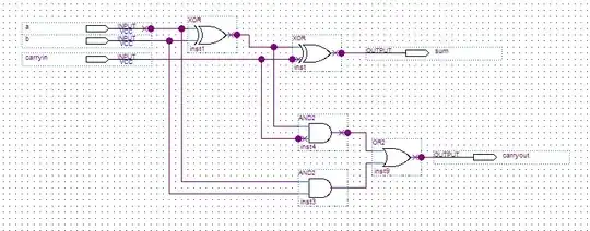

I've understood that the behaviour is correct when I make a simple adder:
But why does carry on light up just because I switch on the + operation for my 4-bit system?

The spec I try to follow has all the details but I can't really understand why the system in effect is like:
1 + 0 = 1
2 + 0 = 1 carry 1 (carry in lights up)

  • Thank you for the comment. I can add the complete details. I think it works but I just don't understand. I download the system to an Altera DE2 board. I'm adding more info to the question so that we can inspect the system. I wanted to make something like a primitive microprocessor. – Niklas Rosencrantz Dec 30 '12 at 20:28
    You might want to clarify what "carry on" is... there is no "carry on" in your schematic, there's only carry in and carry out. – Shamtam Dec 30 '12 at 20:54
  • Thanks for the investigation. I mean that carry in IS on, by lightning up when I download the complete system to my Altera DE2 board. I can test +1 counting up but I can't control + the way I understand from the designs. I isolated the problem to the adder and found that I don't understand why carr in turns on its light on the board just because I switch on the code for operation +. I verified this in the summer and it worked so I suspect that I'm just misunderstanding and forgetting how I wired this. – Niklas Rosencrantz Dec 30 '12 at 23:07
    We can't explain (although DrFried has a pretty good guess) why carry in is on if you don't show us what's connected to carry in. Do you have a schematic for the relevant part of the board you're using? – The Photon Dec 31 '12 at 16:21
The question doesn't contain near enough detail, so I'm mostly making assumptions here...
Carry in is an input. I suspect you stop driving the carry-in input (so it "floats") when you switch to addition mode.

  • Thank you for the answer. I think my design is correct and that I just don't understand the behavior. I've linked to the spec for which I use an Altera DE2 education board. – Niklas Rosencrantz Dec 31 '12 at 13:40
