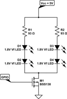

I'm stuck confirming that the current pulled in a circuit will be 15mA.
If I have hypothetical LEDs that pull 15mA each from 1.8V, and they are put in parallel (I know this is not a good idea, but just wondering what happened if is) with a 5V power input, the diagram should look something like this:
The LED's aren't actually 1.8v 15mA in the schematic, but lets just say that they are. Correct me if I am wrong: I supply 5V, the 213 Ω resistor drops the voltage by 3.2V.
This means that going into parallel, we have 1.8V, which is perfect for lighting negligible-resistance LEDs.
The LEDs at this voltage draw 15mA each.
Now here's where my understanding ends: I know that voltage is equal for every parallel branch, 1.8V, but does the current ADD together and the total pulled current will be 60 mA because of the 4 branches?
I tried to calculate the current of the circuit using Ohm's law. V = IR. 5 = I * 213, I = 23.5 mA. Is the pulled current actually 23.5mA, and the current is 'used' by the resistor? Or do I calculate the total current by subtracting the resistor? (I want to make sure I'm not pulling > 40mA for an Arduino)
I know I asked a lot of questions here and I apologize. Any help would be appreciated.

First, note that LEDs are current devices, not voltage. Their brightness is regulated by setting the current.
Second, LEDs have a fixed voltage drop, called the forward voltage, or Vf that stays more or less the same regardless of the current passing through the LED (it does increase slightly with current.)
Because LEDs are semiconductors (diodes), they will not pass significant current until the Vf voltage is met. Once it is met, the LED lights, and further voltage increases beyond Vf causes the LED current to rise rapidly. This non-linear behavior is the reason for the current limiting ('dropping' or 'load') resistor in most LED circuits.
The 1.8V Vf value you state is the low-end of typical for a red or yellow-green (although they are available.) More common for those colors is 2.1V
If you're assuming perfectly Vf-matched LEDs (a bad idea, by the way) with a stated Vf of 1.8V, you will have a corresponding IR drop across the resistor of:
  • Resistor IR drop = (Vcc - Vf) = (5V - 1.8V) = 3.2V.
Since we know this Vf stays more or less the same regardless of LED current (within a reasonable range), we calculate the resistor current as:
  • (Vcc - Vf) / R1 = 3.2V / 213 ohm = 15mA.
This current through the single resistor is the same as the total current for all the LEDs (Kirchhoff's Current Law). Therefore, each LED gets only 1/4 the current, or 3.75mA. Probably not what you intended.
If you want each LED to actually get 15mA, you can make one of the following changes:
  • use one 53 ohm resistor for all four (bad idea due to matching), or
  • use separate 213 ohm dropping resistors for each LED (preferred)
Either way your total current will be 60mA. That's okay for an external FET, but it's really way too much for your Arduino GPIO.
A better solution, given your 5V supply and Vf of 1.8V, would be to wire two pairs of series-connected LEDs and use a dropping resistor for each series pair. Then your total current is only 30 mA (15mA each pair.) Your dropping resistors would be (5 - 1.8 - 1.8) / 15mA = 93 ohms. Not only does this reduce draw on the driver, but it's twice as efficient.
Even then, 30mA is still kind of a lot for a GPIO. Instead, I’d recommend using a low-side FET to drive the LEDs. Also consider choosing a high-efficiency LED type that gives adequate brightness at a reduced current.
Here's what that all looks like:

I think you should be looking at this Problem from another point of view. The Arduino is capable of supplying 40mA and you want your LEDs to be in parallel. This means you want each branch to draw 10mA. You should absolutely put a 500 Ohm resistor on each branch, a bit more to stay on the safe side.
Using a single 213 Ohm resistor will limit the circuit current to 23.5 mA and your LEDs won't be powered properly. To answer your question, the resistor doesn't use the current, it limits the maximum value of current flowing in the circuit and a voltage drops on it.

Figure 1. Series connection of LEDs.
In your example you're using LEDs with a Vf of 1.8 V on a 5 V supply. That means you can series connect two of them and use your current more efficiently. Now you need only 2 x 15 mA = 30 mA.
Let's say the GPIO voltage will drop to 4.8 V at 30 mA (you'd need to check the datasheet) then you need to drop 4.8 - 1.8 - 1.8 V = 1.2 V across R1. \$ R_1 = \frac V I = \frac {1.2}{15m} = 80 \ \Omega \$.
Be careful with running close to max on the pin specifications and note that there will be a maximum current for the whole chip. Remember that all the current has to go through the tiny gold bonding wires on the V+ or GND pin of the chip.
The way LEDs work, the voltage varies very little even while the current varies a lot. That means the voltage will be approximately 1.8 V, for currents in the mA ballpark. If you set the current to exactly 1 mA, or 10 mA, the voltage will be very predictable at about 1.8 V. If you set the voltage to exactly 1.8 V, you'll have no idea what the current will be, it might be uA, it might be 100 mA. It will vary with the temperature, and the particular diode.
The way we express this is that the LEDs have a very low dynamic, or incremental, or differential, resistance.
... but lets just say that they are. Correct me if I am wrong: I supply 5V, the 213 Ω resistor drops the voltage by 3.2V.
If the LEDs are dropping roughly 1.8 V, then there will be about 3.2 V across the resistor.
This is the LED nominal forward voltage. This is not perfect for lighting them, this is approximately what you get when you pass a current through them.
No. The LEDs at exactly this voltage would draw anything from uA to 10s of mA. The LEDs at 15 mA will drop roughly 1.8 V, depending on temperature and the specific LED.
If the LEDs somehow drew 15 mA each, then the four parallel LEDs would draw 60 mA.
You've used V = 5 V in the calculation. There's not 5 V across the resistor, only approximately 3.2 V due to the LED drop, which gives you roughly 15 mA through the resistor. This will then split into the four LEDs, giving about 4 mA each (giving the figure to the precision that a parallel connection of LEDs warrants).
You could get 5 V across the resistor by shorting the far end of the resistor to ground, but then you'd have no voltage to drive the LEDs. As you let the far end of the resistor rise to 1.8 V to turn the LEDs on, the voltage across it drops to 3.2 V, so the current through it becomes lower.
The resistor doesn't 'use' current. You could regard it as 'using' the difference in voltage between the supply and the LEDs.
The reason we use a resistor here is to define an operating current for the LEDs. The resistor dominates the LED's very low incremental resistance with a real, high, resistance. That way, if the supply voltage varies, or the forward drop of the LEDs vary, the current will remain approximately the same.
