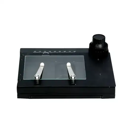

My binocular microscope has a couple of spring-steel "tabs" that can hold the board, but are to big and too short to hold components. (see image below)

Example of tabs on my current microscope:
