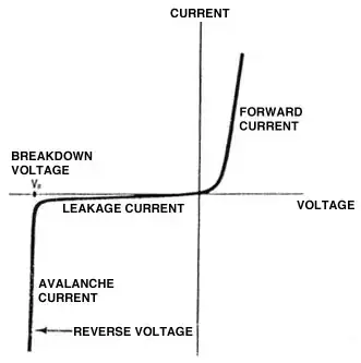

As for diodes, ideally, a diode allows current to flow through it in only one direction, from anode to cathode. Specifically, above a certain "threshold" voltage, it only requires a very small increase in voltage to increase the current to astronomical levels:
(CC image from openwetware.org)
The reverse breakdown behavior (large reverse current when high reverse bias is applied) is normally considered a non-ideality rather than part of the ideal diode behavior.

  • The curve shown is not quite right. The whole curve should be shifted down with the knee on the RHS in the 4th quadrant which is the regime in which PV cells operate. – placeholder Dec 29 '12 at 08:07
    @rawbrawb, That can't be right. Operation in the 4th quadrant implies the component is delivering power to the rest of the circuit, which diodes don't do. Except of course photodiodes (and maybe PV cells), **when** they have optical power applied to them. – The Photon Dec 29 '12 at 15:20
  • THat is correct, in the 4th quadrant it does deliver power. And you are also correct in that the curve shifts down with applied light. I'm just so used to looking at these curves with applied light I forgot about the curve shift. – placeholder Dec 29 '12 at 15:22
