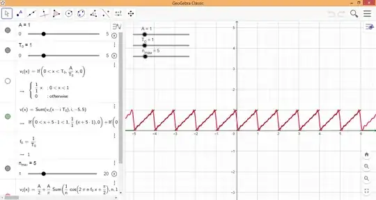

Obviously, the fundamental frequency of \$v(t)\$ in equation (4) is 1 Hz. This GeoGebra app shows both the original signal (in green, given by equations (2) and (3)) and its Fourier series approximation (in red, given by equation (4)). Here's a screenshot:
Sawtooth signal
