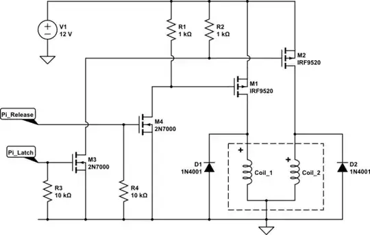

  • @JonasMechtheim May it fairly be said that you are looking for an ultra-lower-power version of [this behavior](https://i.stack.imgur.com/KoL5a.png)? – jonk Sep 27 '20 at 10:45
  • @JonasMechtheim It can actually all be done with just four BJTs and one PFET and guaranteed below \$10\:\mu\text{A}\$, as well. Just tested an idea. It's also robust in that a pulse train is generated only when power exists. This pulse train is required to keep the PFET on via re-triggering. Without that, the PFET goes off. So it is continually monitoring the voltage supply and doesn't require any sequential logic. That's the approach I'd recommend you consider. It's just a couple of RCs, a voltage trigger, an SCR from BJTs and diodes, and some positive feedback. – jonk Sep 27 '20 at 11:32
  • @JonasMechtheim A PUJT might simplify it. But those are less common devices and there's only a few of them made anymore. Plus, I suspect they'd require more of a current draw from your supply, especially when disabled by your \$3.3\:\text{V}\$ control input. Discrete BJTs give you lots more degrees of design freedom. Few learn how to develop and conceive discrete designs anymore, though; so most would recommend boutique ICs if one can find them. – jonk Sep 27 '20 at 11:45
  • @jonk spot-on with the drawing, although the "3.3 Clear" could also equally be "!3.3V clear", I'm flexible there (comes from a MCU). The solution you're proposing with four BJTs sounds fantastic, do you have a reference to how I could set this up? I'd like to stay away from PUJTs, if it can be done with BJTs. Thanks in advance, it sounds fantastic! – Jonas Mechtheim Sep 27 '20 at 12:20

Here is an alternate latch circuit based on standard logic gates.
R1-C1 form the power-on-reset that forces the circuit into the closed state. A 3 V Kill signal latches the output off by turning off the voltage translation transistor Q1. R3 ensures that the MOSFET is completely off. for a more "firm" turn-off, decrease it to 10K.
When the output is off, the circuit static current should be in the uA range, just the static current of the two gates. There is no off-state current through any of the resistors.
NOTE: Instead of AC series CMOS, use single-gate low voltage devices such as the Picogate series from Nexperia. TI has two gates in one package: https://www.ti.com/product/SN74LVC2G132
NOTE - Schematic is incorrect; gates should be NOR's. Update coming.
