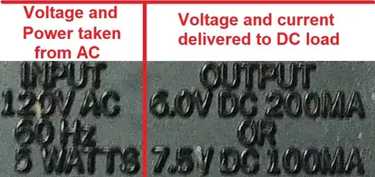

I have a genuine GE 5-1075A AC/DC power brick that says that it can provide 200 mA at 6 V (1.2 W).
My use case is that I want to power some old cassette players which I believe these are compatible with. The cassette players only list "6 V" and no current rating.
Why is this power brick listed as 5 W if it also states voltage and current nowhere near that value?

Does this help?
In other words it's only about 20% power efficient.
Because it consumes a maximum of 5 W on the 120 VAC side to give you 1.2 W @ 6 V on its output. Not very efficient, but there you have it.

    More likely that the input is actually 5 VA, due to high inductance and poor coupling. This is done to reduce cost but also provides a measure of safety if output is overloaded or shorted. https://electronics.stackexchange.com/questions/393802/can-a-short-circuit-in-the-output-of-a-transformer-be-dangerous – PStechPaul Jul 28 '22 at 07:34
