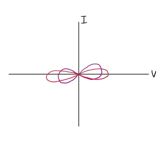

I'm trying to understand what an IV plot of a memristors tells me in terms of physical properties. So these are the questions with the relevant plots:
  1. If I have a pinched hysteresis loop that does not cross the origin (as in the image below), so either displaced on the x-axis or y-axis, or both, what does that physically signify? How does it differ from a memristor whose curve crosses the origin?
  1. How does a tilted pinched hysteresis loop differ in physical properties from one that is not titled? What does a rotation/tilt by an angle theta physically signify for a memristor ?
  1. What does the area of a pinched hysteresis loop resemble - if my input variable is voltage (so a voltage controlled memristor)? And what do different area values signify in terms of physical properties of memristors? And what is the effect of scaling on the physical properties of a memristor?

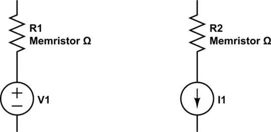

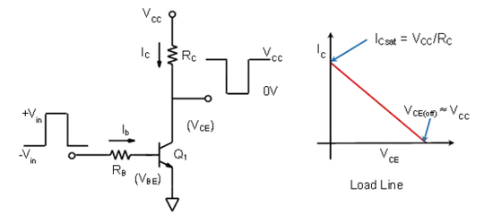

It means you have a constant voltage or current offset and it looks like this in a circuit (this does not happen with real memristors with real resistive materials AFAIK, I know there are no materials that you can build in a constant current offset (obviously), maybe a constant-ish voltage drop) :

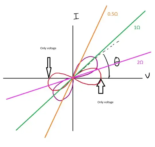

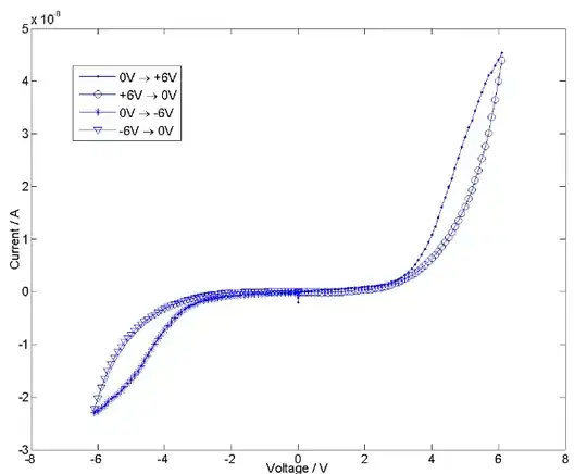

Well, I think you have to have some kind of tilt for it to be a memristor, otherwise it would be a voltage source with no current and only producing voltage at that point, and that wouldn't make sense physically, as the resistor would be producing voltage with no current, usually resistive materials produce a voltage after current . I suppose an ideal memristor could have no tilt. Real curves look like these and I haven't seen one that doesn't always have resistance:
Source: Figure 3-My, and others’, spiking memristors are true memristors: a response to R.S. Williams’ question at the New Memory Paradigms: Memristive Phenomena and Neuromorphic Applications Faraday Discussion
The tilt is a resistance offset. You could think of it as adding a resistor to the no-tilt situation. You can see here resistance lines drawn for 0.5Ω, 1Ω and 2Ω resistors on the same plot.
