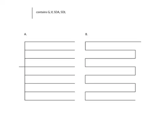

I have 64 i2c devices wired together. They all seem to work correctly until randomly between 30s-1m of sending signals, the bus will hang.
Here is how I have it wired:
bus topology diagrams
It's currently wired as diagram A. Do I need a configuration like B? Is there anything else that would cause a device at random and a random time to pull the bus low?

The shape of the bus doesn't matter as much. What usually matters the most is the total capacitance of the bus. A good conservative approach is to keep the capacitance below 400pF. Sometimes, it's possible to run I2C bus at higher capacitance, if you lower the speed. Stiffer pull-ups [fewer Ω] help too, but if they are too stiff, the buss will not work.
Typically, high bus capacitance is addressed with (1) buffering and/or (2) switching.
  1. There are specialized ICs for buffering I2C capacitance. PCA9515, for example.
  2. Each branch of the bus by itself has a low enough capacitance. But if all branches are connected together, their combined capacitance becomes too high. Add a multiplexor such that you can connect one branch at a time. The master will "see" the capacitance of only a single branch.
Handy application note: Troubleshooting I2C Bus Protocol. It shows both methods.
Diagnostic tip. Reduce the size of the bus (perhaps, by a half, if you can) and see if it hangs less or the same.
More info would help. The pictures in the O.P. don't show: mechanical dimensions, how your circuit is constructed (PCB, or cables, or breadboard).
An oscilloscope screen shot would help too.

  • Each device is mounted on a PCB. It's a similar design to http://unknowndomain.co.uk/blog/2009/02/19/reverse-engineering-a-blinkm/. I don't own a oscilloscope, but may pick one up. Right now, I don't have any additional pull-up resistor besides the internal Arduino resistors. I'll look into measuring capacitance. I have a multimeter, but still new to all of this. Thanks for your help. – kelly Dec 27 '12 at 02:02
  • I should also note that the the total the 64 devices are in a matrix that is 30in x 30in. Worried that the long wire length is also giving me issues. – kelly Dec 27 '12 at 02:06
  • @kelly Internal pull-ups in the ATmega are 20kΩ. This is way to weak for I2C pull-ups. This may be the main source of your woes. Add external pull-ups. I would start with value of 2.2kΩ (also, what Olin said). – Nick Alexeev Dec 27 '12 at 02:42
  • @kelly I2C was designed for communication within one circuit board. 30in x 30in (0.75m x 0.75m) would result in the total bus length of 6.75m. You're pushing it. But, you might get away with it. – Nick Alexeev Dec 27 '12 at 02:45
  • Thank you! Will pick up some 2.2kΩ resistors and report back if that solves the issue. – kelly Dec 27 '12 at 03:41
    The 2.2kΩ resistors worked perfectly. Thanks again for your help! – kelly Dec 30 '12 at 00:32
