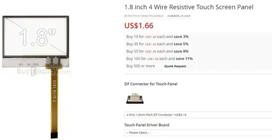

Touch panels seem to have a connector that has thin lines on a thin film.
Factories should have sophisticated machines to do such thing, but what about for individuals at home? If a person wants to connect such a thing to an Arduino or Raspberry Pi, is it possible? I wonder if there is some kind of adapter that makes the printed lines into common pins.

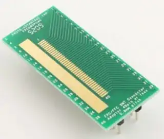

You could get one of these (picture) and solder a few cable to the pin holes which then connects to the Arduino/Raspberry Pi
Picture: https://www.amazon.com/Flexible-Adapter-Raspberry-Sealink-Equipment/dp/B0819V6G9M
6 pins (0.5mm 1mm pitch): https://www.amazon.com/uxcell-Converter-Couple-Extend-Adapter/dp/B07RWRK4WX/ref=sr_1_4?dchild=1&keywords=fpc+ffc+5+pin&qid=1600629771&sr=8-4

The things you refer to aren't called "Ribbon Cables". A ribbon cable looks like this:
actual ribbon cable
They're made of many conductors, each a cyclinder in approximately cylindric insulators.
What you show is FPC cable, flexible printed circuitry cable.
It's more like a PCB than a cable!
FPC
You can design these with normal PCB design tools, and order them in factories.
Then, they'll have the shape you define, and there's a lot of connectors you can "snap" them into, and these come with info on how the connecting parts (golden in your photo) have to be designed.
FFC/FPC connector
There's also "middle ground": FFC, which is basically FPC with "simple" shapes that someone else already designed for you:
FFC
However, the FFC/FPC connectors typically require designed PCBs themselves – it simply makes little sense trying to connect a high-density cable to e.g. a breadboard, geometrically. So, you'd need a breakout board (a type of adapter) to connect your board to a connector to connect a cable that's actually a board to another board.
That might very well be the point where it pays to learn how to design your own boards so that you don't need another adapter. Also: When someone decides that it's best to use FPC like your touchscreen designer did, chances are there's high-speed signals involved, which you can't transport well on anything with a 2.54mm pitch, anyways.
But all that is very much in the realm of possible for individuals – designing PCBs is not that hard anymore, and ordering them has become incredibly easy and cheap. You just upload your KiCAD, Eagle, … file to e.g. oshpark.com, and get your PCB a while later for little money.

From site referenced:
The FPC is the soldering type, no need connector.

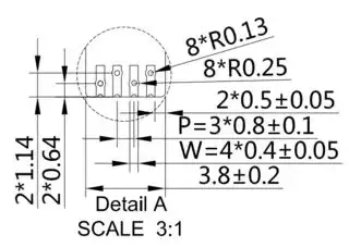

If you check the datasheet for touchscreen, pins appear to have a 0.8mm pitch (P).
You need a 0.8mm pitch FPC to 0.1 inch pitch adapter or Adafruit Multi-pitch FPC Adapter. Doubtful at 0.8mm pitch you will find throughhole connector, but SMT connectors exist.
Or choose one with a connector or adapter board. Solder wires to connector or plug into USB for adapter.
