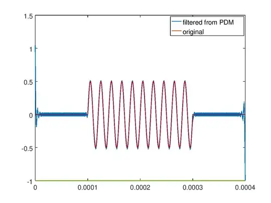

Filtered Results
The filtering code at the top of this answer gives the recovered signal. I have shifted (-0.5) and scaled (x2) the filtered result for easy comparison to original. It is shown below. Magnified portions show that the noise is still present. If the amount is too much for the given application, repeat the full procedure above with tighter specifications.
filtered result magnified filtered plot 01 magnified filtered plot 02
