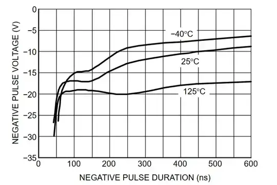

Now, regarding the negative bias, consider the simplified representation below:
When you turn the upper-side MOSFET on, the inductor is energized and the current circulates from the HV branch to the load. When the PWM controller instructs the upper-side transistor to turn off (max peak current is reached, end of the PWM pattern etc.), the low-side transistor is not immediately turned on: a certain amount of deadtime (DT) is inserted to avoid shoot-through between the two devices. You give time for the proper blocking of the upper-side MOSFET before actuating the low-side one. During this DT period, the current needs to find a path to keep circulating in the same direction. It takes the low-side body diode which is now forward biased. As a result, the HB pin of the driver swings below ground to the diode forward drop \$V_f\$. Then, later on, the low-side MOSFET turns on and providing its \$r_{DS(on)}\$ is low enough, the drop approaches 0 V.
What can cause problems as highlighted in my comment in the negative swing during the DT period. Depending on the driver technology (isolated or not fully-isolated driving block) there can be substrate injection and an erratic behavior can be observed. It can then end up as an IC latch (with possible destruction) or the premature re-start of the upper MOSFET with all nasty consequences. The body diode alone cannot be held responsible of the neg. swing but of course all the resonant circuit around made of package and layout parasitics (resonating \$LC\$ networks) are. The need for a good layout with short and thick traces is important as you can guess. The negative pulse can be quite energetic and needs to be carefully be monitored in various worst-case scenarios (hard switching of the bridge for instance in fault mode). Look for the presence of characterization data such as the below one to make sure your circuit can accept what you observe in your board:
People consider the voltage swing but it truly the amount of injected charges \$Q\$ so it is current versus time that matters. But as voltage is easier to observe, this is what you usually have in data-sheets.
As a conclusion, selecting a HB driver is certainly not to be done on price only but on the careful observation of its behavior in harsh operating conditions such as overload, start-up sequence or short circuit at various operating temperatures. As your application is unique, you can't really escape a qualifying session. A long process indeed but it will shield you against adverse results when production has started. As a disclaimer, beside writing books, I work for a semiconductor manufacturer.
