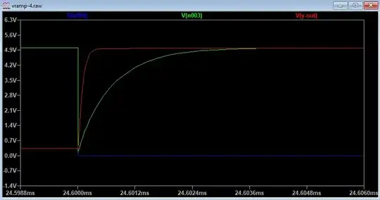

Here is the detail view of the negative pulse, and don't worry about the red trace, which is the charging of C1.
Here is the trace showing the positive edge pulse too, chopped off by D1. The problem of this is that it works with the switch application that Ben Eater uses, but it might not work driven directly by a TTL device since the momentary current it needs to sink to discharge C3 (a whopping full ampere) is not possible with a TTL device.
