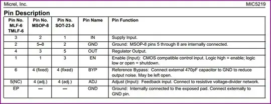

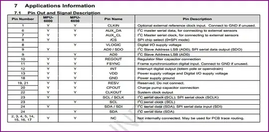

So, for the direct answer, everything is in the datasheets for the two chips, specifically these two tables:
Pin Purpose 1
You can see above that the CPOUT pin is the charge pump capacitor connection (this will be used for an internal boost circuit, often for generating the higher voltages necessary whilst programming e.g. a microcontroller/FPGA - in this case it seems it's supplying the X,Y and Z sections with a bias voltage, see clip below) So, this is why the cap is placed there (the datasheet will have details on the value to use.
Charge Pump
Pin Purpose 2
The second part of your question is answered basically by the table above, this gives the pin number and description of function.
