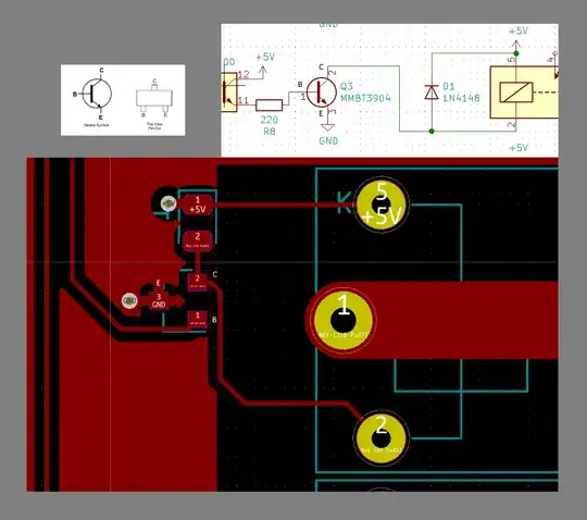

I recently developed a circuit board for use with my Raspberry Pi 3 A+. The purpose of the board is to accept various inputs, but also toggle some relays (two solid state, and two regular). My current issue is that I can't seem to turn relays C and D on. I'd hoping someone could help me find out where I went wrong.
Here's a snippet of my schematic for reference:
This is what I know so far:
  • All the outputs on the pi are working properly (I can see ~3.3 V at R2 - R5 when I toggle the respective pins on).
  • All channels of the optocoupler are working properly (I can see ~5 V at R6 - R9 when I toggle the respective pins on).
  • I don't know how to tell if a transistor is doing it's job with a multimeter, but if I plug a resistor and LED into J8 or J9 I can verify those channels are working as the LED lights up when I toggle the respective pin on.
  • I can say it's not the protection diode installed wrong, as removing it had no effect.
  • If I run a wire from GND to pin 2 of either of the relays, they click.
My best guess right now is that I chose the values for R6 - R9 incorrectly for the application.
Datasheets:
Update
It was brought to my attention that the collector and emitter of my transistor may be flip-flopped. After reviewing my design and the datasheet I'm inclined to agree. Here's a picture for reference:
Solution
This issue was caused by the choice of SOT-23 symbol when creating my PCB in KiCAD.
As you can see in the picture below, there are a number of symbols associated with transistors in the KiCAD default library:
When mocking up my circuit I chose the first option 'Q_NPN_BCE'. The key elements here are the last three letters which define the pinout in KiCAD. What I didn't know at the time, but know now, is most common SMD transistors have a 'BEC' pinout rather than 'BCE' (or 'CBE', 'CEB, etc...).
If you are running into a similar issue, you can verify which pinout your transistor is by referring to the datasheet.
The pinout of a SOT-23 package is counted from the first of the two pins going in a clockwise motion:
To determine which symbol you should pick in KiCAD, just read out the pins in the same order.
In my case it's Base, Emitter, & Collector, or 'BEC'. So when choosing the symbol from the KiCAD library, I should choose the 'Q_NPN_BEC' option.
Hopefully this can help someone having a similar issue in their circuit design!

    how are the grounds connected? – jsotola Sep 09 '20 at 00:03
    On my PCB, I filled all the area between the traces with a common ground plane. Everything marked GND is connected directly to that. – Toms Jensen Sep 09 '20 at 00:10
    Test if the relay portion is actually working (irrespective of your control circuit): take a short wire from ground and touch it to pin 2 of the relay. You should hear it click. – td127 Sep 09 '20 at 00:22
    Clicking confirmed. – Toms Jensen Sep 09 '20 at 00:34
    the relay power grounds are not separate from the RPi ground? ... what's the point of using opto-couplers then? – jsotola Sep 09 '20 at 00:35
    That was previously brought to my attention. I decided to keep the optocoupler to distance potentially noisy circuitry (120v AC) as much as I could from the digital portion. To be honest though, I'm unsure if that is grounded in reality or wishful thinking. – Toms Jensen Sep 09 '20 at 00:38
  • @Toms Jensen, you design looks nice. I am writing up the draft version of my answer. It would be nice if you can make comments or counter suggestions as I go along. Have a nice project. Cheers. – tlfong01 Sep 09 '20 at 02:27
    You get a click, good - your relay is fine. So now, when you turn assert your on condition the transistor should be saturated and its collector voltage something like 0.3V. Do you see that? – td127 Sep 09 '20 at 02:35
  • @Toms Jensen, I have finished a draft of my answer, showing how to read the 2N3904 NPN BJT and Songle relay data sheets and calculate the biasing resistor Rb for 2N3904. The optocoupler part is in fact easier that 2N3904. so I would recommend you to try to do your own design, which is a good way to learn. It would be nice if you can show you optocoupler design and calculations as another answer to this question. I would be happy to comment on your design and give you an up vote. :). Happy circuit designing. Cheers. – tlfong01 Sep 09 '20 at 09:55
    What voltages do you measure between collector and ground when you toggle the pin? – ocrdu Sep 09 '20 at 10:23
    What is the resistance of the coil on the relay? if it’s low, your connecting +5v to ground thru the 3904 transistor. What does the +5v do when the relay is enabled? – user262567 Sep 09 '20 at 00:39
    According to the datasheet it looks like the resistance of the coil is 70 ohms. – Toms Jensen Sep 09 '20 at 00:42
    I also don't think I understand the second part of your question... – Toms Jensen Sep 09 '20 at 01:01
This may be the answer, as I don't see anything else wrong in the schematic, and the other tests you did point to the transistors' not switching properly:
According to its datasheet, pin 3 of the MMBT3904 is the collector, and pin 2 is the emitter; in your schematic, they have been swapped.
You may want to measure the voltages between the collector and ground when you toggle the pin to see if the transistors are behaving as they should and are connected properly. The measured voltages should be about 5 V and about 0.3 V.
ocrdu
  • 8,705
  • 30
  • 42
    Hey, I checked and I think your guess is correct. I added an additional image above for context. I'll have to conduct a test later when I have a moment. – Toms Jensen Sep 09 '20 at 14:40
    Assuming the transistor is backwards, though, why would I be able to turn on an LED connected to J8? The fact that I was able to test the circuits for A & B made me rule out any architecture issues before the diode in the chain. – Toms Jensen Sep 09 '20 at 14:44
    Alright, this was it. I jury-rigged the transistor into the correct position and everything works. I guess I'll need to source a different part with the correct pin-out... – Toms Jensen Sep 09 '20 at 15:50
    If you swapped collector and emitter you may have gone beyond the transistor's CE reverse breakdown voltage, which makes them leak current in an unelegant way. Either that, or I'm wrong and there is another problem 8-). Only measuring the transistors will give you an answer. Edit: or change the connections and test, that will do as well. – ocrdu Sep 09 '20 at 16:03
    Ah, that's probably correct. The circuit seems to be working well now though. I really appreciate the help! Thanks! – Toms Jensen Sep 09 '20 at 16:51
