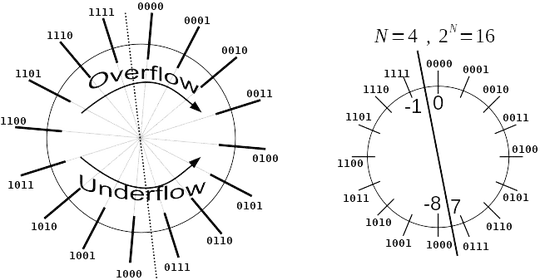

digital logic is normaly build just to handle unsigned integers but you can just map ones complement and two's complement to these integers and if you interpret the unsigned integers as twos complement numbers it turns out that the result is correct in the limits of availible bits.
-4 = 1100
       1100
     + 1100
carry 11000
       1000
1000 = -8
schnedan
  • 2,538
  • I like the right figure, but the left one is misleading. Overflow should also be shown in the lower half. – Janka Sep 08 '20 at 15:37
  • @Janka you are right to the point, that its the same technical issue... I just did paste n copy from my studies formula collection. So we used both words just to make clear at which position of the circle the overflow happened – schnedan Sep 08 '20 at 16:38
