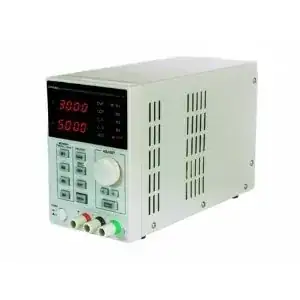

I just order a KORAD KA3005P - Programmable Precision Variable Adjustable 30V, 5A DC Power Supply from Amazon.
I watched Dave's Review/FAIL video of it and then watched the follow up video and a follow up video by Charles Holtom from TrioSmartCal . For ~$100 I thought it was worth giving it a try.
KORAD KA3005P
From SRA
Features:
  • Compact Design
  • Dual 4 Digit LED Displays
  • Digital Controls
  • Output switch control
  • Switchable between 110v and 220v
  • 4 sets of parameters can be stored inside for fast recall
  • Keyboard Lock to prevent accidental changing of set parameters
  • Circuit protection for over load, short circuit and over temperature.
  • Automatic switching between mA and A display
  • Quiet variable speed fan
  • 2 Year Warranty!
Operating Conditions:
  • Input voltage:110V +/- 10% switchable to 220V +/- 10%
  • Frequency range: 50- 60Hz
  • Operating temperature: 32- 104 F (0- 40 ºC)
  • Operating humidity: < 80%RH
  • Storage temperature: 32- 158 F (0- 70 ºC)
  • Storage humidity: < 70%RH
Stable Voltage:
  • Output Voltage Range: 0- 30V Continuously adjustable
  • Setup Resolution: 10 mV
  • Setup Accuracy: <0.05% +20 mV
  • Ripple: < 1mVRMS
  • Read back Accuracy: 10 mV
  • Temp. Coefficient: < 0.1% + 10mV
  • Read back Temp. Coefficient: < 100 ppm+10 mV
Stable Current:
  • Output Current Range: 0- 5A Continuously adjustable
  • Setup Resolution: 1 mA
  • Setup Accuracy: <0.1% +3 mA
  • Ripple: < 3mARMS
  • Read back Accuracy: 1 mA
  • Temp. Coefficient: < 0.1% + 5mA
  • Read back Temp. Coefficient: < 100 ppm+5 mA
This power supply seems like it should be mentioned when considering a bench power supply.

    How did it work for you? Any drawbacks? – ergosys Jul 25 '13 at 23:30
    I've been using this thing for a while now. I'm finding that it has some issues. The 1st one was that the face plate fell off and I had to use some double sided tape to stick it back on. Now I'm finding that the power switch does not operate. If the PS is plugged in it is running. The power switch must be a soft switch and something is broken (mosfet, I assume). I haven't looked into fixing it but I am seriously looking at getting a different PS. – Hair_of_the_Dog Aug 06 '13 at 22:22
