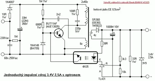

As I have seen Amstrong oscillator circuit configuration in mobil phone chargers, that could be used here too. Simply you could detect overvoltage through a opto-isolator and kill the oscillation and force transistor to cut off.
You only just need a feedback. Study these example. enter image description here
Original link to circuit,it's public on web
Please don't do modifications to this circuit , instead get the idea and do modifications to your joule theft design.
Hope this will fix your problem. [ Mobil Phone charger idea have been shamelessly used in everywhere now :P ]
