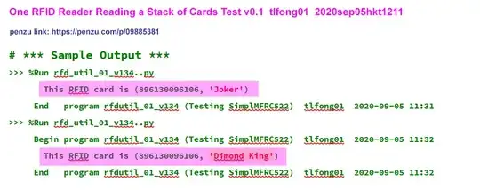

rfid test 1

So I first tested 4 playing cards one by one, giving them names "Heart Ace" etc. Then I read them back one by one without any problem.
Next is the fun part. I give a two card stack, but the reader hangs. I think it gets confused of a corrupted signal.
Next I tried to splay them, very very slowly, as I was playing poker. Then a weird thing happens, the reader gave the following error message:
AUTH ERROR!!
AUTH ERROR(status2reg & 0x08) != 0
What is also interesting is that the Thonny python 3.7.3 prints the above message
IN BRIGHT RED!!! (This is my first time seeing a red warning from Thonny, after programming Thonny python for a year or so!)

And this is a sample output
Sample Output
%Run rfd_util_01_v134..py
     Begin program rfdutil_01_v134 (Testing SimplMFRC522)  tlfong01  2020-09-05 16:17
       spiPortName   = SpiPort00
       spiSpeedName  = 1 MHz
       This RFID card is (647176253282, 'Diamond Ace                                     ')
     End   program rfdutil_01_v134 (Testing SimplMFRC522)  tlfong01  2020-09-05 16:17
     Begin program rfdutil_01_v134 (Testing SimplMFRC522)  tlfong01  2020-09-05 16:18
AUTH ERROR!!
/ to continue, ...
/ to continue, ...

%Run rfd_util_01_v134..py Begin program rfdutil_01_v134 (Testing SimplMFRC522) tlfong01 2020-09-05 16:17 spiPortName = SpiPort00 spiSpeedName = 1 MHz
   This RFID card is (504284031262, 'Heart Ace                                       ')
   This RFID card is (233736302454, 'Club Ace                                        ')
   This RFID card is (896130096106, 'Spade Ace                                       ')
%Run rfd_util_01_v134..py Begin program rfdutil_01_v134 (Testing SimplMFRC522) tlfong01 2020-09-05 16:18 spiPortName = SpiPort00 spiSpeedName = 1 MHz AUTH ERROR!! AUTH ERROR(status2reg & 0x08) != 0
   This RFID card is (896130096106, '')
 End   program rfdutil_01_v134 (Testing SimplMFRC522)  tlfong01  2020-09-05 16:18
