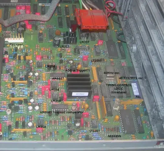

You haven't seen different colors until you've seen inside a scope, or at least an old one.
HP 54501A
From a HP 54501A.
You can take a guess at what the colors mean, but without knowing the manufacturers it is difficult, nigh impossible. In this example suspect the green ones are precision (probably ±0.1%), while the pink and blue ones have larger tolerance, due to the relative quantities of them.

    They don't make 'em like they used to. – Toby Jaffey Oct 15 '10 at 16:43
  • Just compare to an equivalent Rigol 100 MHz scope or even the 50 MHz models and you can see the difference. Then again, the scope did apparently cost $3,300 USD new. – Thomas O Oct 15 '10 at 16:55
  • wow - it's like a sweet shop with all the bright colours :) – Jim Oct 25 '10 at 15:07
    waking a 6 year old thread up... but I just wanted to add that the green "resistors" are likely inductors. Small wirewound inductors that looked like green resistors were commonplace around that period. – Brian Onn Jul 24 '16 at 11:42
