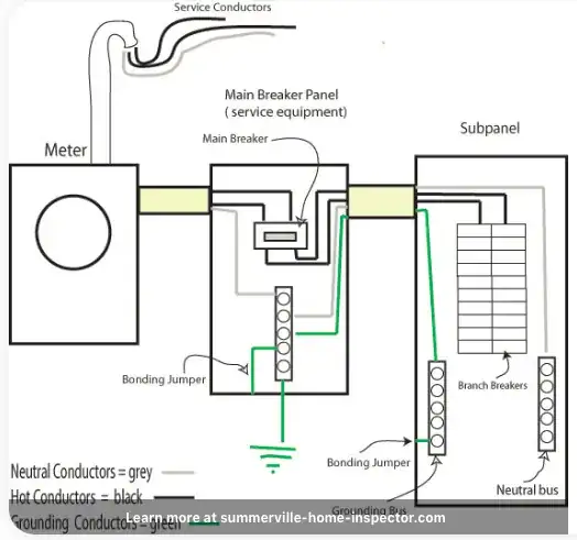

See the picture below which shows that connection in the panel. (Ignore the subpanel/panel split, the point is that it shows the neutral bonded to the ground at the panel.)
